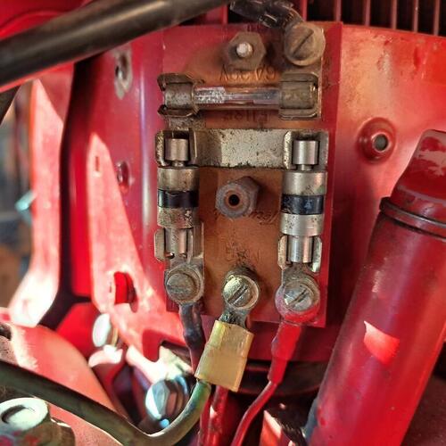

Engine Tecumseh 3 amp charging with diodes and fuse SM.pdf 1.0.0
Service instructions
1 page 464KB
6 amp fuse part number 29561
Diode part number 30842 replaced by 36909 - 2 required

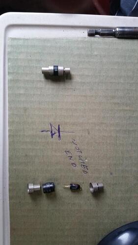

They do come apart to replace the diode inside.
Radio Shack 276-1143 or 1N5402
