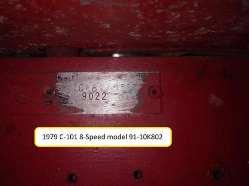

Model 91-10K802 serial 15223 - Build date 1979 9022 January 22 Monday (This ID plate is below the dash housing)

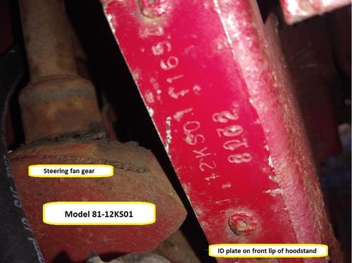

This tractor has a 2nd ID plate showing model 81-12KS01 serial 11654 - Build date 1978 8102 April 12 Wednesday appears to be stamped over 8073 March 14 Tuesday (This ID plate is vertical on the left front edge of the hoodstand facing forward and beside the steering gears.)
