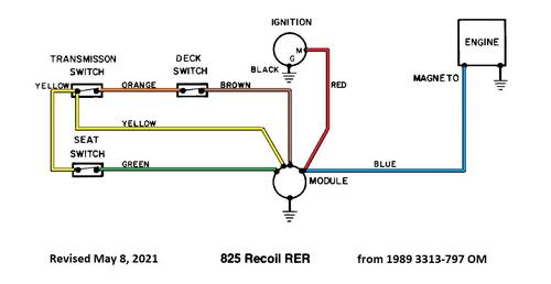

Model 56123
Operator manual #3313-797
Wiring
28 pages 2.06MB
IPL #3313-820
28 pages 5.24MB
2 pages 109.52KB
1989 8-25 Rear Engine Rider model 56123 Serial 9000001-9999999 - Recoil start
1989 serial numbers that have shown up for the 56123
9003999 - Could be a 56128

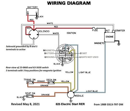

Model 56127
Wiring
28 pages 2.06MB
IPL #3313-820
28 pages 5.24MB
2 pages 104.50KB
This is an electric start model but the Details page shows recoil start
Toro names this as a 7-25 but when you get to the manuals it is a 8-25 and in places a 825.
1989 8-25 Rear Engine Rider model 56127 Serial 9000001-9999999 - Electric start
1989 serial numbers that have shown up for the 56127
