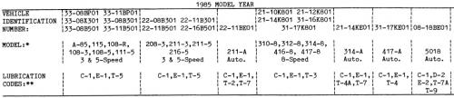

Lube chart SS

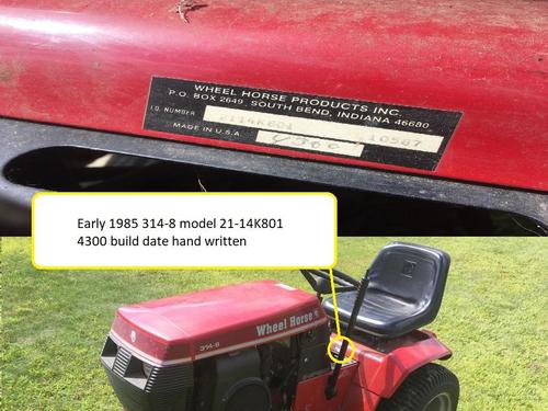

1985 314-8 model 21-14K801
1985 serial numbers that have shown up for the 21-14K801
10587 - Build date 1984 4300 October 26 Friday (4300 is written on the decal) Decal placed on the front of the rear fender pan just behind shifter slots.
10682
10729
Uses Kohler K321S-60424 with 3 amp unregulated charging system
