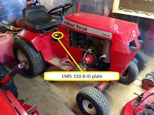

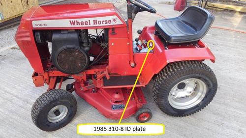

Tractor 1985 310-8 D&A TIPL SN.pdf
6 Screenshots
34 pages 3.56MB
Original IPL #810386R1
Transmission drive belt 78-7100 replaced by 7473 - HB x 81.9" or 5/8" x 81.9"
3 pages 116.70KB
1985 310-8 model 21-10K801 - Uses 110996 transmission with 1" axles and 4 pinion gears
1991 transmission ipl
4 pages 556.96KB
(Serial numbers 11752, 11753, 11754 and 11755 used the 110995 transmission with 8 pinions and 1-1/8" axles - Source 1991 ipl)
1985 serial numbers that have shown up for the 21-10K801
10153
10253
10526 - All red paint with silver background decals
10635
10771
11471
11589
11752 used the 110995 transmission with 8 pinions and 1-1/8" axles - Source 1991 ipl)
11753 used the 110995 transmission with 8 pinions and 1-1/8" axles - Source 1991 ipl)
11754 used the 110995 transmission with 8 pinions and 1-1/8" axles - Source 1991 ipl)
11757
12226
13167
19109
