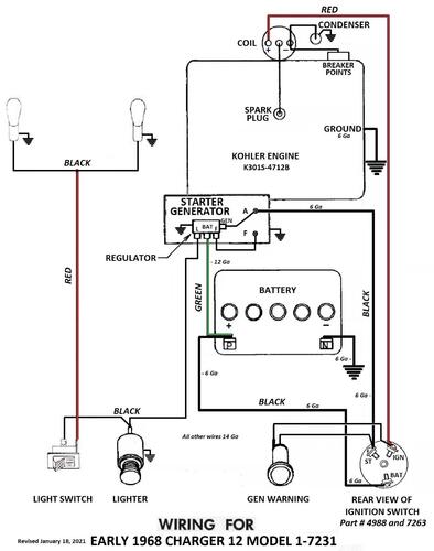

Tractor 1968 Charger 12 Early production D&A Wiring Rev SN.pdf
5 Screenshots
Details and attachments
3 pages 116.46KB
Early production used Kohler K301S-4712B with starter/generator and battery ignition
The "Details" page is for early production - the tractor model number was the same
The 1967 wiring should be the same for the 1968 early production
Wiring Color pdf
1 page 346KB

(Late production used Kohler K301S-47147B with Bendix starter, 10 amp alternator and magneto ignition with points and condenser)
Wiring and ignition switch is completely different on the two

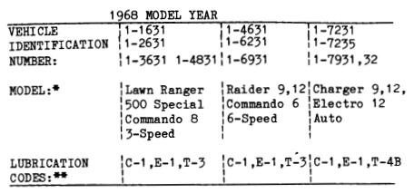

1968 Charger 12 model 1-7231 - Early production

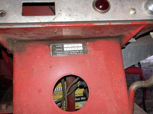

1968 serial numbers that have shown up for the early production 1-7231
395880 - Kohler K301S-4712B with starter/generator and battery ignition
395922 - Model number a guess
396003
396091
396240
396510
420619
420675
