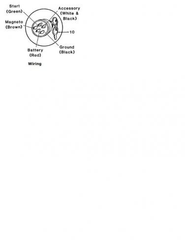

Uses 102981 ignition switch for electric start (Illustration taken from Dixie Chopper wiring diagram)
