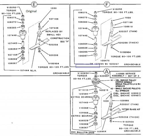

Mower spindle assemblies could be E, A1, F or Z
For A1 see service bulletin 292B
