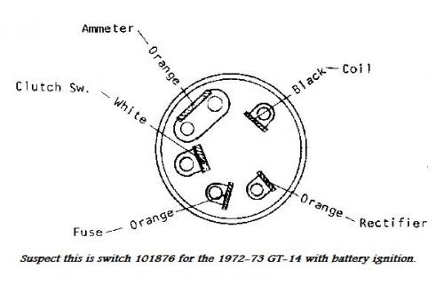

Uses Kohler K321S-60149A Listed at Kohler as having 15 amp stator and battery ignition

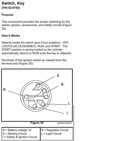

May have used 101876 or 101-876 ignition switch nla Guessing this may work - (101917 5-terminal 4-position S-R-B-I-A) replaced by 92-6785 5-terminal 4-position S-R-B-I-L ignition switch and 8658 replaced by 108544 solenoid
Terminals on 101876 battery ignition switch may not be identified - This switch is no longer available from Toro and appears to be a heavy duty switch designed to take a heavy starter load. The ipl's @ Toro also list a 8658 solenoid so a cheaper alternative switch should be available.
1 page 86.8KB
Should be a suitable replacement ignition switch 92-6785

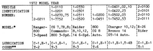

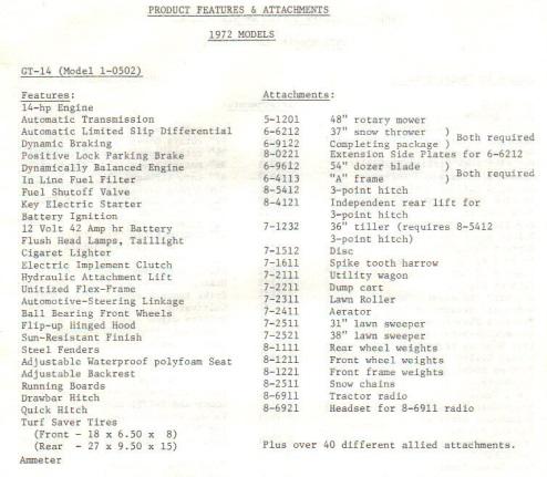

1972 GT-14 model 1-0502

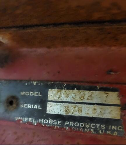

1972 serial numbers that have shown up for the 1-0502
855864 - Model 1-0502-7
855704
855902 - Model 1-0502-7
878187
878274 - Located in UK
878331
878410 - Model 1-0502-7
878412
878457 - Model 1-0502-7
896942 - Model 1-0502-7
897054 - Model 1-0502-7
897061 - Model 1-0502-7
1972 GT-14 model 1-0503
