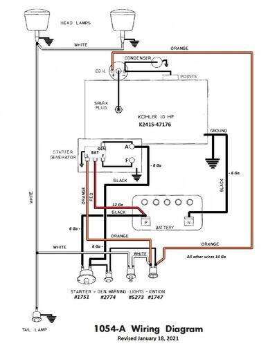

Wiring Color pdf
1 page 182KB
1965 model 1054-A
Wrong engine spec number 47176 @ Toro - should be 46215A
Tractor drive belt 1592 nla from Toro (4L x 82.00" or 1/2" x 82")
Hydraulic pump belt - Wheel Horse 1591 nla Use Toro 83-2900, Gates 6748 3/8"x48", Napa 3L480W 3/8"x48".
Starter/generator belt
Kohler 10hp, 12hp - 235262 (7345 Gates .410" x 35.09" 36 degree) (25-7345 Napa .410" x 35.09" 36 degree)
Wheel Horse 1593 (3L x 34.4") - nla (Gates replacement 6735 3/8" x 35" 38 degree)
