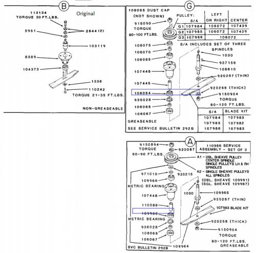

This file was found with 1974 A-90 Special model 2-4300 ipl at Toro MPV
If you search for 5-0602 the R-26 Rear Engine Rider 26" single-blade deck comes up as a 5-0602 also which must be wrong.
Suspect this 5-0602 replaced the 5-0601
Mower spindle assemblies could be B, A1, G2 or Z
For A1 see service bulletin 292B
For G2 see service bulletin 292B
9187 center blade and 9188 left and right blades replaced by 8969 3-blade kit and no longer available (Hole 5/8in.x3/4in. Double-D)
8969 blade set available again from Toro June 4, 2019
