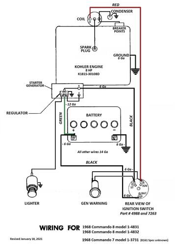

Wiring Color pdf
1 page 330KB

The original parts list for the 1968 Commando 8 list a 7262 ignition switch but that is the part number for the key (typo). Switch is 7263.

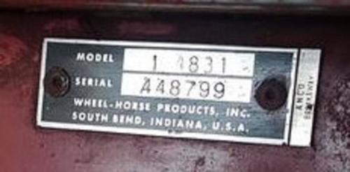

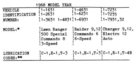

1968 Commando 8 model 1-4831
1968 serial numbers that have shown up for the 1-4831
111707 - Made in Belgium - Kohler K181S-30108d Serial D150544
111722
391352- Made in USA
391467
391657
391687
395048
395060
403928
405276
405448
405629 - May be a model 1-4631
414130
415081
415109
415382
422806
422896
422974
433155
433289
440729

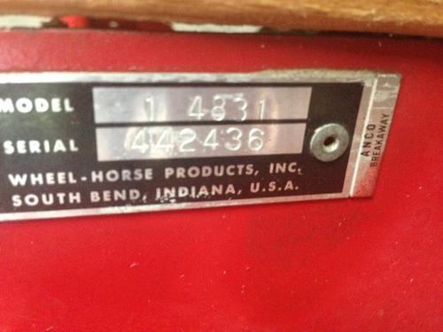

442436 - Has Anco breakaway tab still on the right side of the ID plate
442475
442596
442657
442728
445328
445399 - Made in USA - Located in the UK
448701
448799 - Has Anco breakaway tab still on the right side of the ID plate
457202 - Has Anco breakaway tab still on the right side of the ID plate

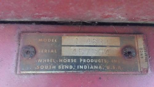

457394 - Has Anco breakaway tab still on the right side of the ID plate
463351
463459
463636
473144
474848
474880
480249 - Made in USA Located in UK
515005
515097 - Made in USA Located in Finland
713789
