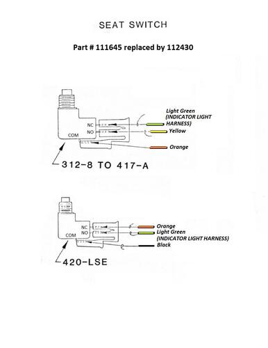

  3. Free
    111645 replaced by 112430 seat push button switch wiring ($58.91 May 22, 2020)
    White wire connector part number 111498 ($3.01 May 22, 2020)
    Same as used with the 111332 pto switches and  used with 114240 and 112418 seat switches.
    Taken from 1986 300-Series 400-Series IPL SM Wiring manual
    Switch push-button 111645 used on
    1986 models 21-08K801, 21-08K802, 21-10K802, 21-10K803, 21-12K802, 21-12K803, 21-12KE01, 21-12KE02, 22-08B302, 22-11B302, 22-11B502, 22-12TE01, 31-14K801, 31-16K802, 31-17K802, 31-17KE02, 31-20KE01
    1987 model B2-11B392
    77 downloads
    Updated

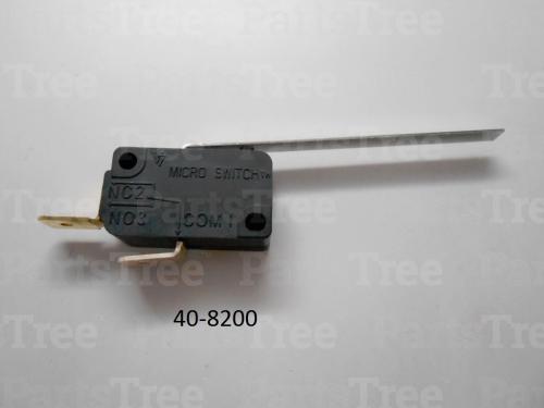

    Taken from #492-4509 Electrical Manual
    40-8200 micro switch used on
    1988 model 56127
    1989 models 56123, 56127, 56128
    1990 models 56123, 56133, 56176, 56177, 56185, 56190, 56195
    1991 models 56132, 56133, 56176, 56177, 56185, 56190, 56195
    1992 models 56132, 56133, 56177, 56185, 56190, 56195
    1993 models 70040, 70060
    1994 models 70040, 70060
    1995 models 70040, 70060

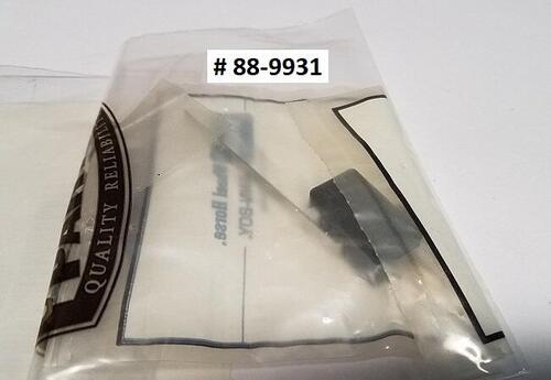

    73 downloads
    Updated
    Taken from the #492-4761 Electrical Manual
    Microswitch description and testing Micro switch
    88-9931 Micro switch used on

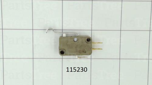

    Taken from #492-3203 Electrical Manual
    115230 clutch neutral switch used on
    1989 model E2-17K502
    1990 models 41-20O801, 41-20OE01, R1-18OE02, R2-17K501, R2-17K502
    1991 models 22-14O501, 22-14OE01, 31-10K802, 31-12K802, 31-16O803, 32-10B5202, 32-10BE02, 32-12B5A3, 32-12BEA3, 32-12O502, 32-12OE02, 41-20OE02, 51-12KE01, 51-16OE01, R2-12O501, R2-12OE01, S2-12B502
    1992 models 22-14O502, 22-14OE02, 31-10K803, 31-12K804, 31-16O804, 32-10B503, 32-10BE03, 32-12O803, 32-12OE03, 41-20OE03, 42-16BE01, 51-12KE02, 51-16OE02, R1-20OE02, R2-12O502, R2-12OE02, R2-16BE01
    1993 models 72040, 72041, 72060, 72081, 72101, 73401, 73421, 73501, 73520
    1994 models 72042, 72043, 72062, 72063, 72083, 72103, 73421, 73501, 73520
    1995 models 72042 x 2, 72043 x 2, 72062 x 2, 72063 x 2, 72103 x 2, 73401 x 2, 73421 x 2, 73501 x 4, 73520 x 2
    1996 models 72042, 72043, 72045, 72062, 73401, 73403, 73421, 73423, 73501, 73502, 73521
    1997 models 72045, 73403, 73423, 73502, 73521
    1998 models 72045 x 2
    1999 model 72047
    2000 model 72049
    86 downloads

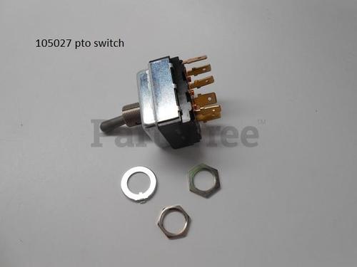

    Switch pto 105027 for electric pto clutch
    The files are photos only
    105027 electric pto switch used on
    1976 D-160 Automatic model 61-16OS01
    1976 D-160 Automatic model 61-16OS02
    1976 D-200 Automatic model 61-20KS01
    1976 D-200 Automatic model 61-20KS02
    1977 D-160 Automatic model 71-16OS01
    1977 D-200 Automatic model 71-20KS01
    1978 D-160 Automatic model 81-16OS01
    1978 D-200 Automatic model 81-20KS01
    1979 D-160 Automatic model 91-16OS01
    1979 D-200 Automatic model 91-20KS01
    1979 D-200 Automatic model 91-20KS02
    1980 D-160 Automatic model 01-16OS01
    1980 D-200 Automatic model 01-20KS00
    1981 D-200 Automatic model 01-20KS00
    1988 724-Z model Z1-24OE01 Zero-turn mower
    1989 724-Z model Z1-24OE02 Zero-turn mower
    80 downloads

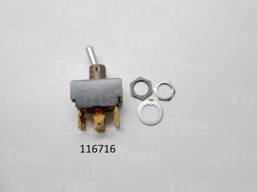

  9. Free
    82-12o502* - Correct
    82 -12o502 - Not correct
    82-12o502 - Suspicious and not checked or determined yet
    Pto switch 116716 used on
    1990 models 32-10B501, 32-10BE01, 32-12O501, 32-12OE01, 32-16BE01
    1991 models 32-12O5A1, 32-12OEA1, 32-12B5A2, 32-12BEA2
    65 downloads
    Updated

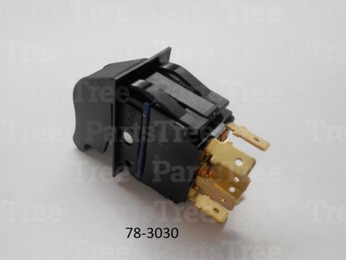

    Taken from #492-4509 Electrical Service Manual
    78-3030 Pto switch used on
    1991 models 22-14O501, 22-14OE01, 32-10B502, 32-10BE02, 32-12B5A3, 32-12BEA3, 32-12O502, 32-12OE02, R2-12O501, R2-12OE01, S2-12B502
    1992 models 22-14O502, 22-14OE02, 32-10B503, 32-10BE03, 32-12O503, 32-12OE03, 42-16BE01, R2-12O502, R2-12OE02, R2-16BE01
    83 downloads

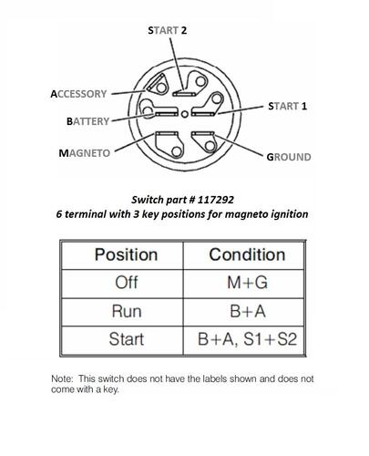

    Switch Ignition Magneto Keyed 920163 replaced by 117292
    1 page from #492-4509 Demystification Guide
    Rotated the switch to place the single terminal at the top.
    1 page 138KB
    6-terminal 3-position for magneto ignition.
    Used on the 600-Series zero turn models with battery ignition by using the A terminal to power the ignition. The M and G terminals are not used.
    Magneto ignition switch 920163 used on
    1990 models Y1-12OE01, Y1-16OE02
    Magneto ignition switch 117292 used on
    1991 models Y1-12OE02, Y1-16OE03, Y1-20OE02 (Y1-16OEE3e found on 3320-673 OM)
    1992 models Y1-16OE04, Y1-16OEE4*e, Y1-20OE03
    1993 models 74021, 74041, 74101
    1994 models 74021, 74041, 74101, 74120
    1995 models 74021, 74101, 74120
    64 downloads

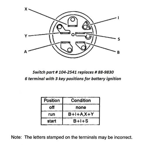

    88-9830 replaced by 104-2541
    6-terminal 3-position for battery ignition - Often used to control a kill relay for magneto ignition
    Used on the XL-Series tractors and Time Cutter zero turn models
    Switch rotated to put single terminal at the top
    1 page 125KB

    104-2541 used on
    2007 models 74406, 74407
    2008 model 74406

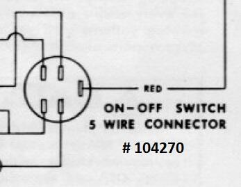

    104270 Ignition switch used on
    1975 models 3-5001, 3-5002, 13-5000
    1979 models 93 -05BP01, 93 -05BP02, 93 -08BP01, 93 -08BP02, 93 -08XP02, 93 -11BP01
    1980 model 03-08EP01*
    1981 model 03-08EP01*
    1982 model 03-08EP01*
    1983 model 03-08EP01*

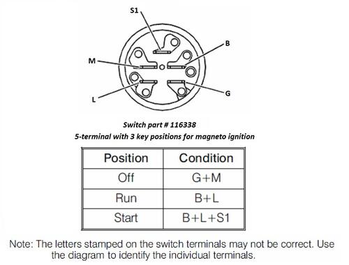

    1 page 163KB from Demystification Guide #492-4509
    1 page 161KB from Demystification Guide #492-3203
    Switch turned over to place START terminal at the top
    1 page 167KB
    How to troubleshoot
    Note on the switch description page - The switch terminals may not be properly identified.
    116338 switch ($50.46 May 22, 2020)
    5-terminal 3-position key switch for magneto ignition
    This switch requires a starter solenoid
    Tractor Switch Ignition Magneto ignition with electric start 116338
    (Threads 5/8"-32) 5-terminal 3-position switch
    116338 5-terminal 3-position available 08/08 $23.80 from RCPW
    Used  1991 thru 1997
    116338 Magneto ignition switch used on

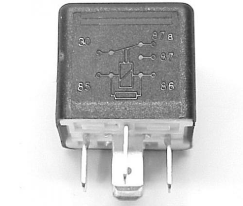

    Relay Low oil 106833 replaced by 99-5365 kit List
    Taken from #492-4207 and #492-4509 Electrical manuals and PSB's
    1 page 64KB
    Used as a kill relay on 1981 B-Series tractors with magneto ignition. The battery style ignition switch controls the relay to ground the magneto ignition.
    Starting in 1986 used in the low-oil starter circuit for single-cylinder Kohler engines.
    106833 3-terminal relay replaced by a 5 terminal substitute in production because of a parts shortage.
    These were replaced by SA121378 service assembly which was replaced by 99-5365 kit.
    The 99-5365 kit contained a 48-4700 relay which has been replaced by 116397 relay.
    116397 relay used on 1990 312-8 for the low oil starter circuit and 1990 200-Series and 500-Series as a starter relay.
    82-12o502*C - Correct and Tractor Series
    106833 Low oil relay used on
    1986 models 21 -08K801, 21 -08K802, 21-10K802*300, 21-10K803*300, 21-12K802*300, 21-12K803*300, 21-12KE01*300, 21-12KE02*300, 31-14K801*400, 31-16K802*400, 31 -17K802, 31 -17KE02, 31 -20KE01
    1987 models 21 -08K803, 21-10K804*300, 21-12K804*300, 21-12KE03*300, 31-14K802*400, 31-16K803*400, 31 -18K801, 31 -18KE01, 41 -18KE01
    1988 models 21 -08K804, 21-10K805*300, 21-12K805*300, 31-14K803*400, 31-16K804*400, B1 -16O801, E1-12K801
    1989 models 21-10K806*300, 21-12K806*300, 31-14K804*400, 31 -16O801, B1 -16O802, E1-12K802
    1990 models R1-12K801, R1 -16O801
    Links to service bulletins

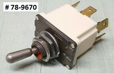

    78-9670 Pto toggle switch
    Taken from the #492-4509 Electrical Manual
    82-12o502*A - Correct and Tractor Series
    78-9670 Pto toggle switch used on

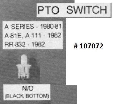

    107072 Push button switch NO=Normally open - Black bottom (This switch not named correctly for this application/year @ Toro)
    Taken from #492-4207 Electrical Service Manual
    107072 Push-button switch used on
    1980 models 01 -14E801, 03-05BP01*A, 03-08BP01*A, 03-08XP01*A, 03-11BP01*A
    1981 models 01 -14E801, 03-05BP02*A, 03-08BP02*A, 03-11BP02*A
    1982 models 01 -14E801, 23 -05BP01, 23-08BP01*A, 23-11BP01*A, 23-11BX01*A, A3 -053201, A3-083201*RR
    1983 model 01 -14E801
    194 downloads

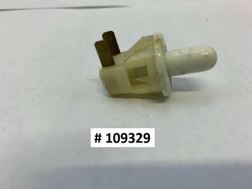

    Push-button switch 109329 NC=Normally closed - White bottom
    Used on pto
    109329 Push-button switch used on

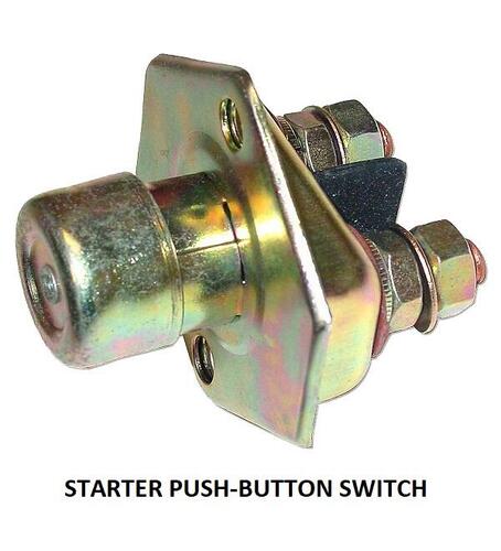

    Large starter push button switch 1751 used 1962-1965
    Screen shot of switch
    1 page 104KB
    Taken from #492-4761 Electrical manual
    Common relay 98-7249
    Used on 1999 312-8 model 73429
    Notice there is a diode or resistor across the coil terminals as illustrated on the relay cover so the polarity of 85 and 86 is important.
    85 should be 12VDC +

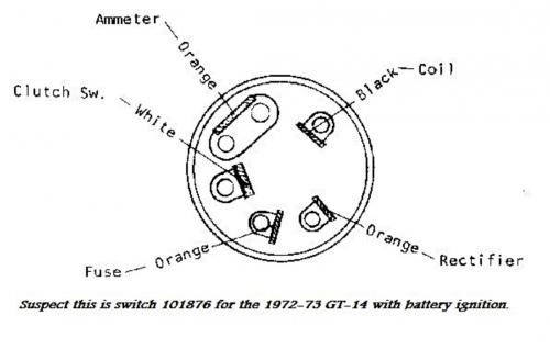

  25. Free

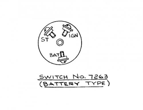

    Illustration from PSB #134A
    101876 switch used on
    1972 GT-14 Automatic model 1-0502
    1972 GT-14 Automatic model 1-0503
    1973 GT-14 Automatic model 1-0502-8 - Listed in attachment interchange
    Not listed at Toro
    Discontinued June 10, 2014
    92-6785 should be a suitable replacement ignition switch if used with a starter solenoid
