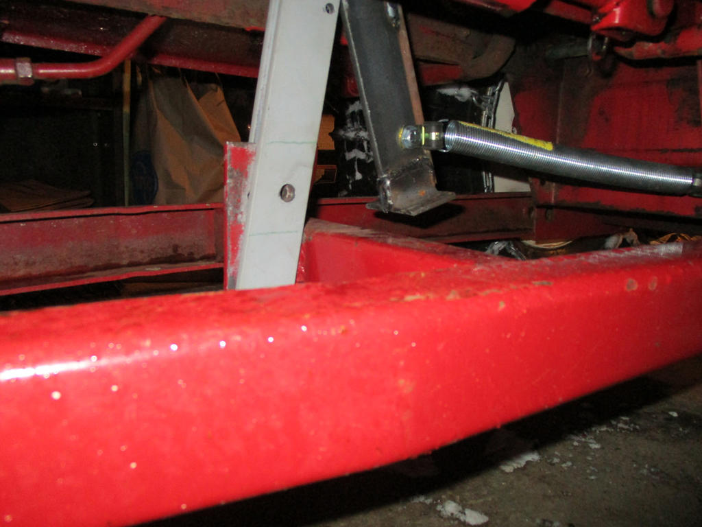

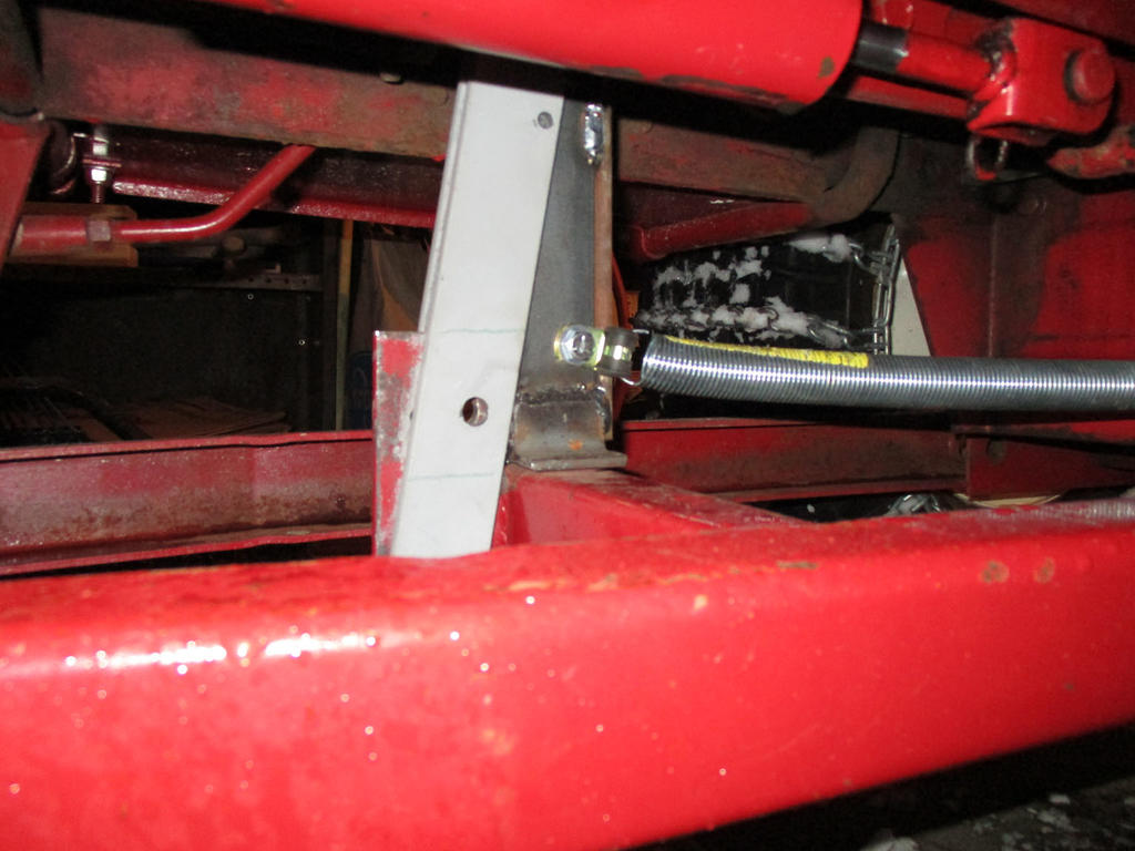

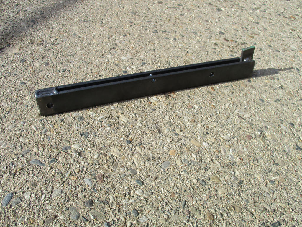

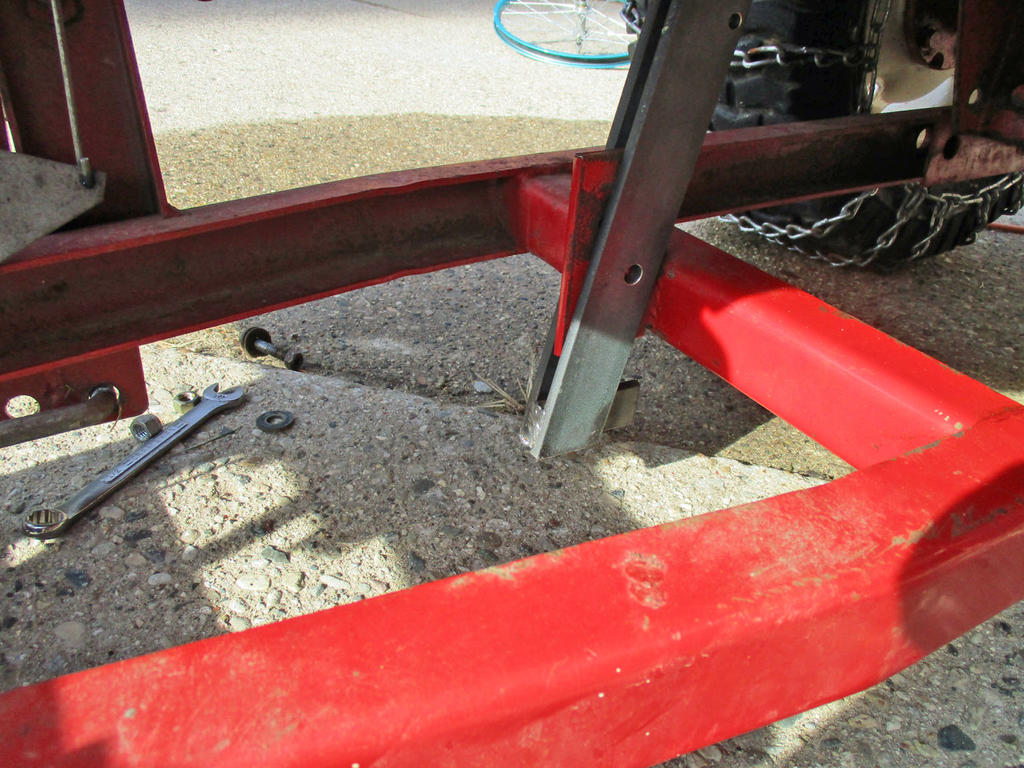

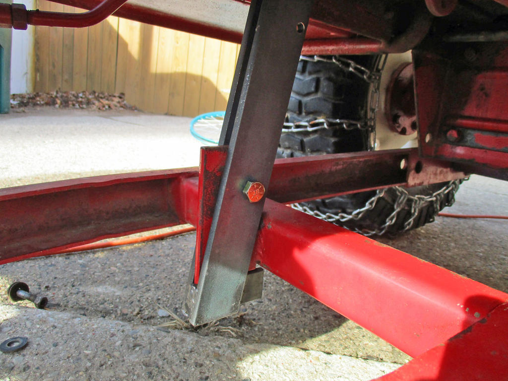

edgro 677 #1 Posted January 21, 2018 I have areas of my drive that I can never seem to clean to the concrete because of the blade floating. I like to have the float because I also have a gravel area, and for piling the snow. I have been thinking it would be nice to have a lift link that would allow float, but could be easily pinned to provide down pressure. It was sunny, in the 40's here in Michigan Saturday so it was a good tractor day. This is what I have come up with. With a pin in the hole, we have push, with no pin it's float I'm going to add a spring to keep the link pulled back to the frame when in float 13 2 1 Share this post Link to post Share on other sites

Sarge 3,464 #5 Posted January 21, 2018 Most of the blade frames have 2 holes to mount the lift link - one is generally slotted about 3/4", which allows for a little bit of float but generally it doesn't work very well overall. Lot of things come into play, such as front tire height, linkage wear and such. Great way to solve this ! Sarge 1 Share this post Link to post Share on other sites

Tankman 3,520 #8 Posted January 21, 2018 Excellent fab, engineered very well. Share this post Link to post Share on other sites
edgro 677 #9 Posted January 22, 2018 Thanks for comments, now we need some snow to test it out. (Raining here now) Share this post Link to post Share on other sites

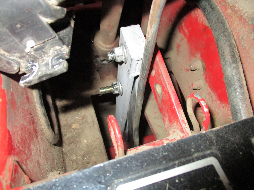

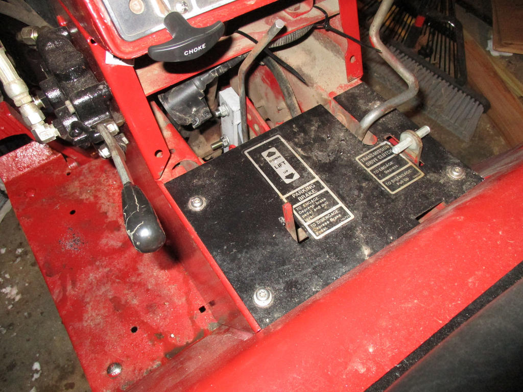

edgro 677 #11 Posted February 4, 2018 So, after plowing with this, I realized down pressure works best with back blading, which is helpful with a few spots I plow. Its a PITA to have to put that pin it and out, so here is second phase of invention. I threw it together and used it today, and surprisingly enough, it seems to work. If I hold the lever engaged, and drop the blade it stays in place, then when I raise the blade it self releases. Shocking to me that a quickie invention actually works on the first attempt. I did have to leave the tunnel cover off, may do something with that later 1 Share this post Link to post Share on other sites
edgro 677 #12 Posted February 6, 2018 Been snowing daily here, had a chance to use this more. It actually works quite well. I've got a lot of spots that I could never scrape clean due to the blade floating. Now we have down pressure on demand to get those areas Share this post Link to post Share on other sites
Sarge 3,464 #13 Posted February 6, 2018 Cool idea, maybe a remote cable to lock it on/off that you could mount on the handle of the blade's angle lever ? I've used barbell weights in the past, stacked right on top of the blade's frame, helps a lot . All of mine are hydraulic, but added weight makes a difference. Sarge Share this post Link to post Share on other sites
edgro 677 #14 Posted February 7, 2018 On 2/6/2018 at 10:49 AM, Sarge said: Cool idea, maybe a remote cable to lock it on/off that you could mount on the handle of the blade's angle lever ? I've used barbell weights in the past, stacked right on top of the blade's frame, helps a lot . All of mine are hydraulic, but added weight makes a difference. Sarge Yes very good thinking. That was in my thinking also, then I figured out about having the lever come up through the tunnel area Share this post Link to post Share on other sites
Sarge 3,464 #15 Posted February 8, 2018 Could just get a spare cover panel - slot it for the handle and add a dogged leg slot to lock it in place, as well as a return spring. Sarge Share this post Link to post Share on other sites
