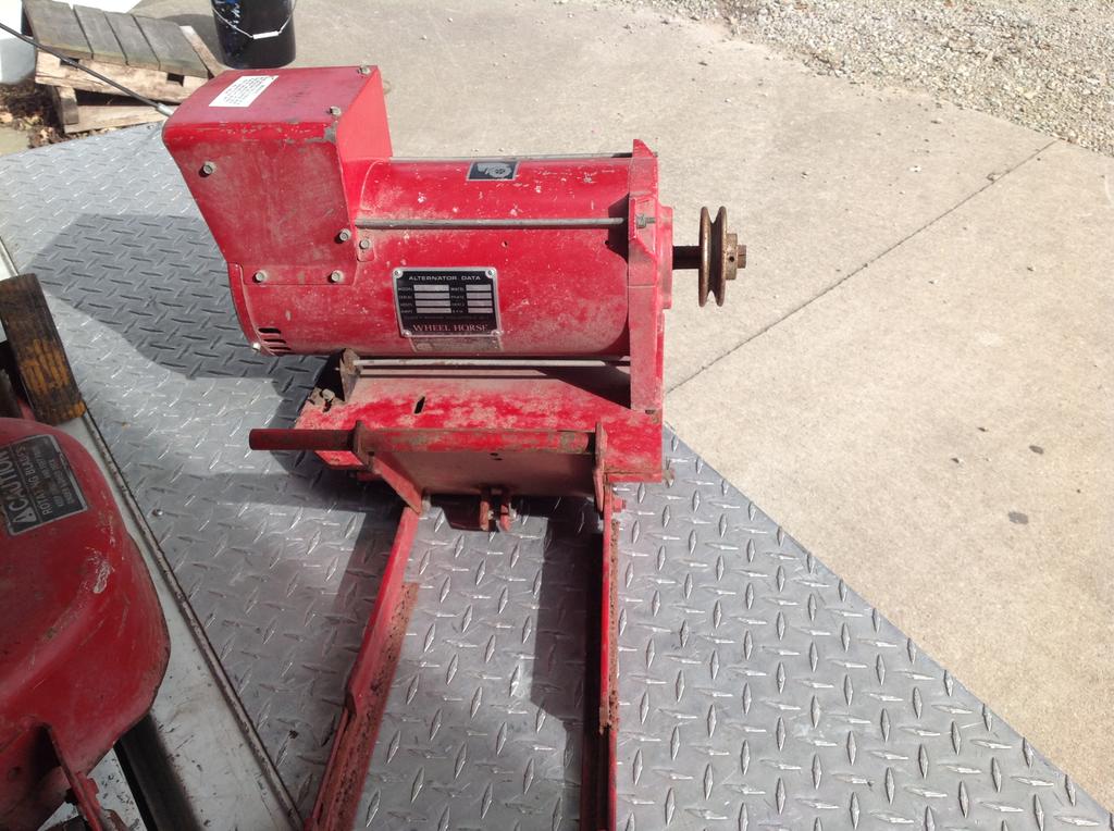

Just picked this up today, looks like the belt is maybe around 63 1/2" anybody have a number for the belt?

Drive belt 107740 (4L x 63.0" or 1/2" x 63")

Thanks, since there isn't a tensioner I'm guessing the belt has to be exactly right.  Which pulley on the tractor do I use, the outside one?
Racinbob
It goes in the outer pulley and the tensioner is the knob on the bottom. :)

What is the lift tube and the flag for, I don't understand why you need to lift it?

The lift is to keep the  generator stable.     It weights a lot.
A very good attachment .

I never use the lift tube. It very difficult to install and remove the tube. I bought a cheap, small 4 wheel movers dolly that I set the generator on. When I’m ready to install I just roll it in to place, line up the attach-a-matic hitches and latch them and pull the dolly out. When I’m done I roll the dolly under the gen, release the latches, and roll the gen into its storage location.  I never have to lift it or lug it around. And, I don’t have to crawl under the tractor and mess with the flag/lift tube.

Is the lift tube and flag the same as on a snowblower?

I believe so but I’m not 100% sure.

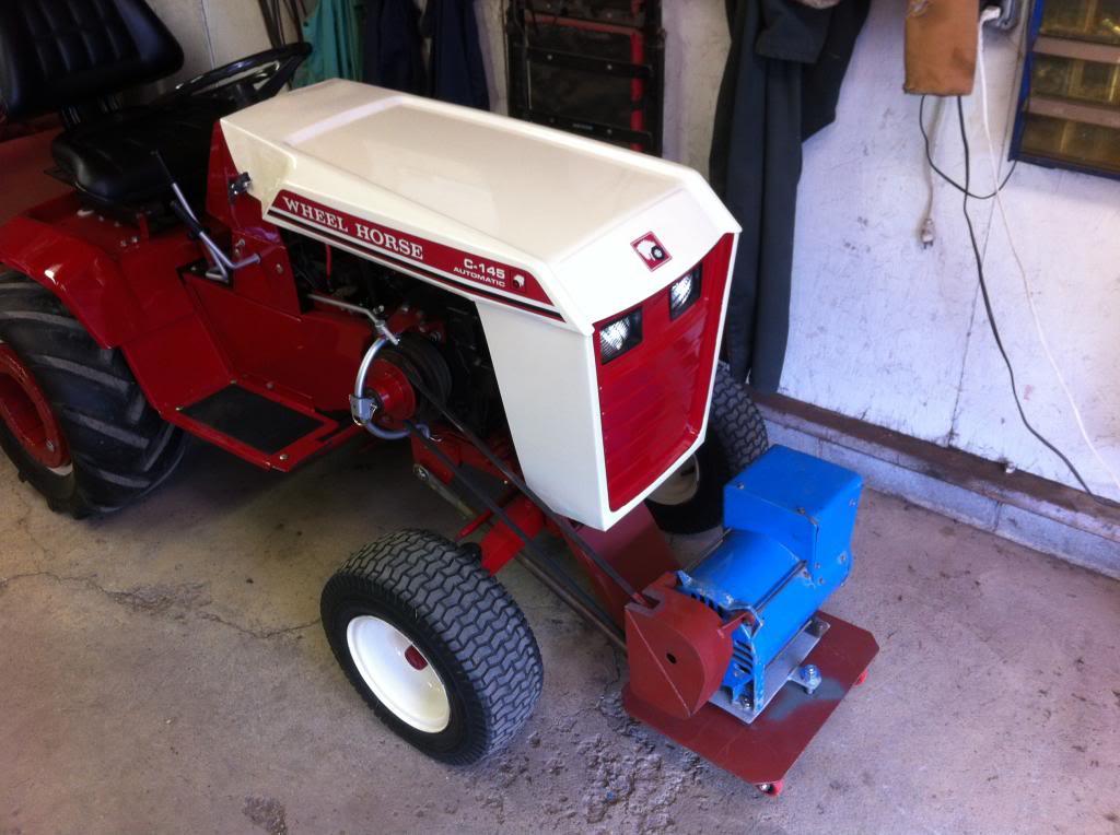

Mike @squonk has got a setup like that hopefully he can chime in.
wheelhorseman
The flag is but the tube is lighter steel (like water pipe)
My genny base is home made. No lift tube and I use a bolt and welded nut from the bottom to tension the belt
