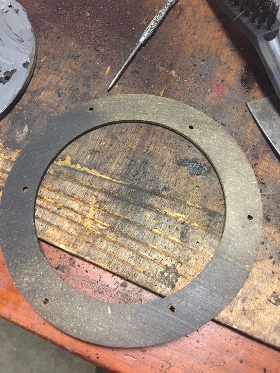

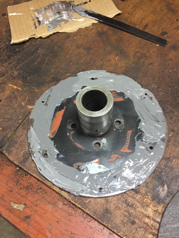

Red144runner 658 #2 Posted June 26, 2017 My 1848 clutch was worn to the rivets and had started to score the clutch face. My dealer sold the clutch embossed onto the pressure plate and it wasn't cheap. I found an nos clutch, drilled the old rivets out and jb welded the new clutch on the old plate. Also had my friend machine the clutch face down. 3 Share this post Link to post Share on other sites

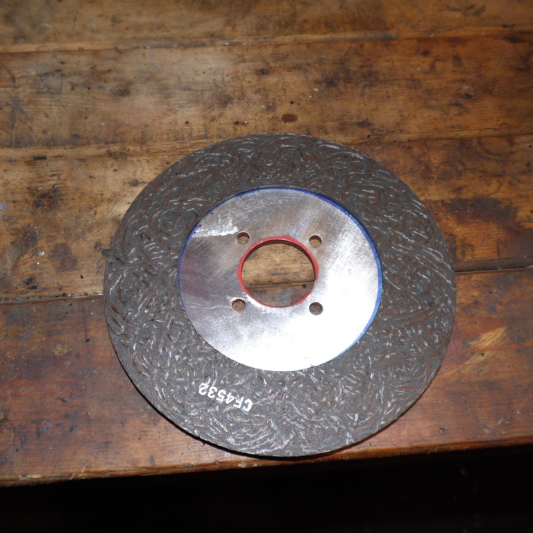

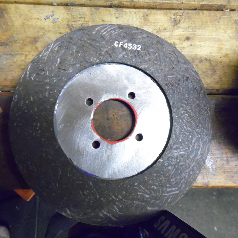

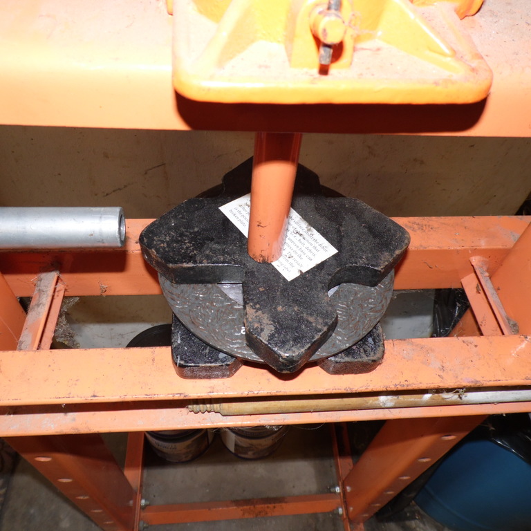

Molon_Labe 731 #4 Posted July 5, 2017 I have replaced several PTO's with this JD B series disc.... http://www.ebay.com/itm/B2354R-One-Clutch-Disc-Facing-Repl-For-John-Deere-Tractor-B-50-520-530/320933399129?ssPageName=STRK%3AMEBIDX%3AIT&_trksid=p2055119.m1438.l2649 If you have a table sander it makes things easier,, a little JB-Weld and a press is all it takes to make your PTO as good as new. 2 Share this post Link to post Share on other sites

Molon_Labe 731 #8 Posted July 6, 2017 7 hours ago, elcamino/wheelhorse said: @Molon_Labe What size was the facing material ? I looked at the site you mentioned but only found 7 inch disks and larger. Did you have to trim the outer diameter of the disk ? The friction disc does extend past the plate by 1/2" but doesn't require any trimming. 2 Share this post Link to post Share on other sites
