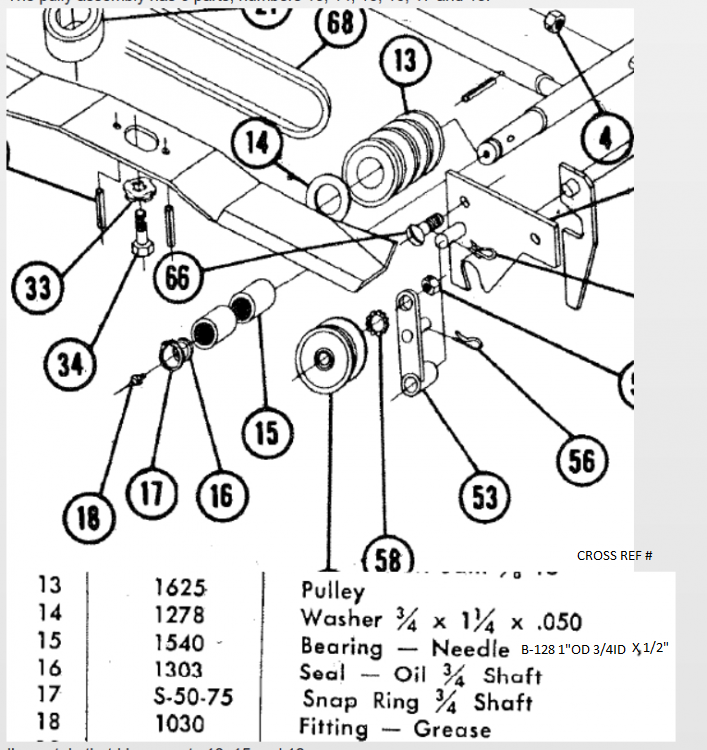

Brit 9 #1 Posted May 15, 2017 Looking for the bearing size for the rm-324 mower deck. This is for the pulley that sits closest to the engine. I found a drawing here on the forum, but its pieced together and im not sure its accurate. If it is, then bearing B-128 will work. Thanks! Share this post Link to post Share on other sites
Tankman 3,520 #2 Posted May 17, 2017 Not sure of the size. Is yours missing? http://www.qbcbearings.com/BuyRFQ/SleeveB_StandardS_P_SB_I.php Share this post Link to post Share on other sites
