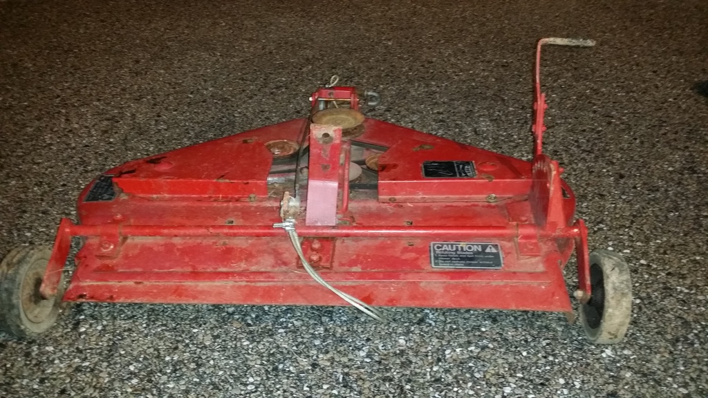

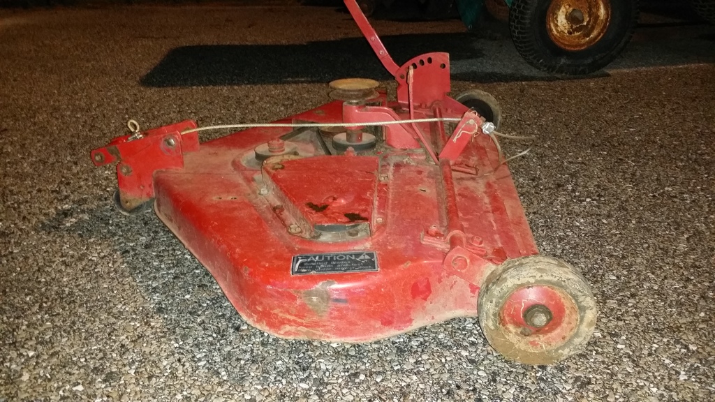

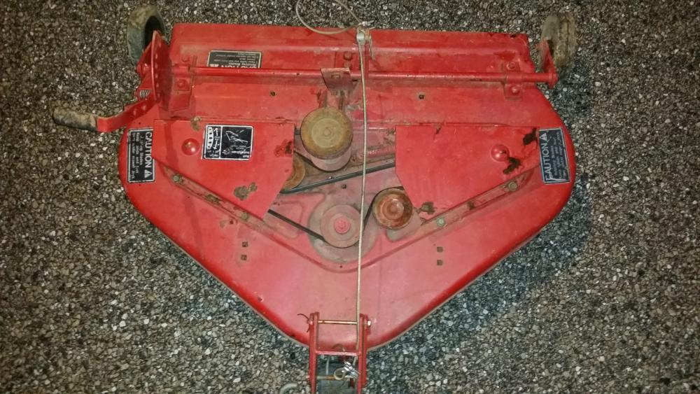

I got a phone call from a friend today who said a neighbor got some Wheel Horse parts to sell. I got this 36 inch rear discharge deck from him for $20. I can't find any ID tags on it. Does anyone know what it fits or what model number it is? :confusion-confused:
It would go on a vertical shaft :wh: like an A series from '75.

My 1980  lawn tractor ( vertical engine ) has a similar mounting bracket to the SD deck. The cable hooks to the front mount under the tractor and using the lift arm for the rear wheel adjusts the height of the deck. Not one of :wh: better idea. The cable stretches over time so the height of the deck decreases.

The only tractors I have are horizontal shaft. I will probably never have a vertical shaft tractor. Is there any way I can convert it to horizontal without too much trouble? :confusion-shrug:Maybe if I find a rusted out horizontal deck and transfer all the brackets and pullies and whatever else is necessary? :confusion-shrug:Or should I just sell it? It looks like there are holes drilled in the deck that are not used. Did they use the same shell for vertical and horizontal?:confusion-shrug:
I have never done it, but there have been threads on doing this and it is just as you said, bolt on the needed parts.  :handgestures-thumbupright:

I have the same deck I salvaged off a vertical shaft B111 (I think that was the model).  It is pre drilled for another hanger and I am hoping to find one on a rusted out deck to mount on my 73-75 800.

I have a rotted out  36" deck out back that I would sell you the parts off that you need to make that deck work on your tractors or possible buy that deck off you and do the conversion  myself
