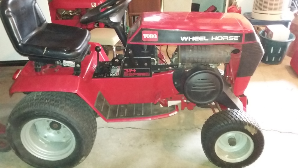

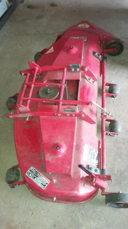

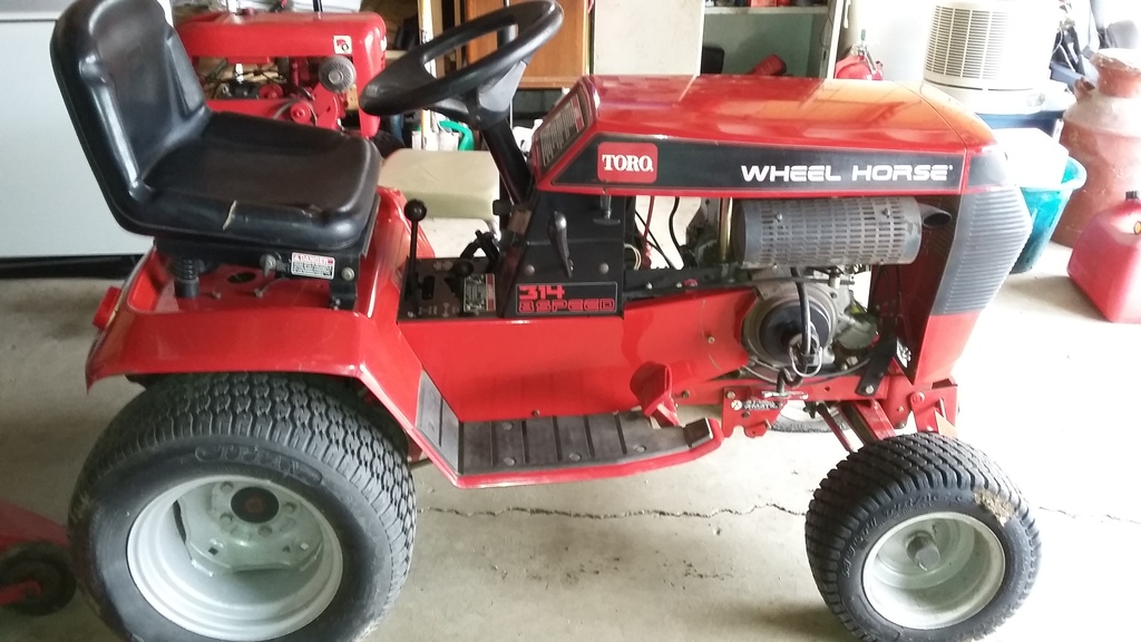

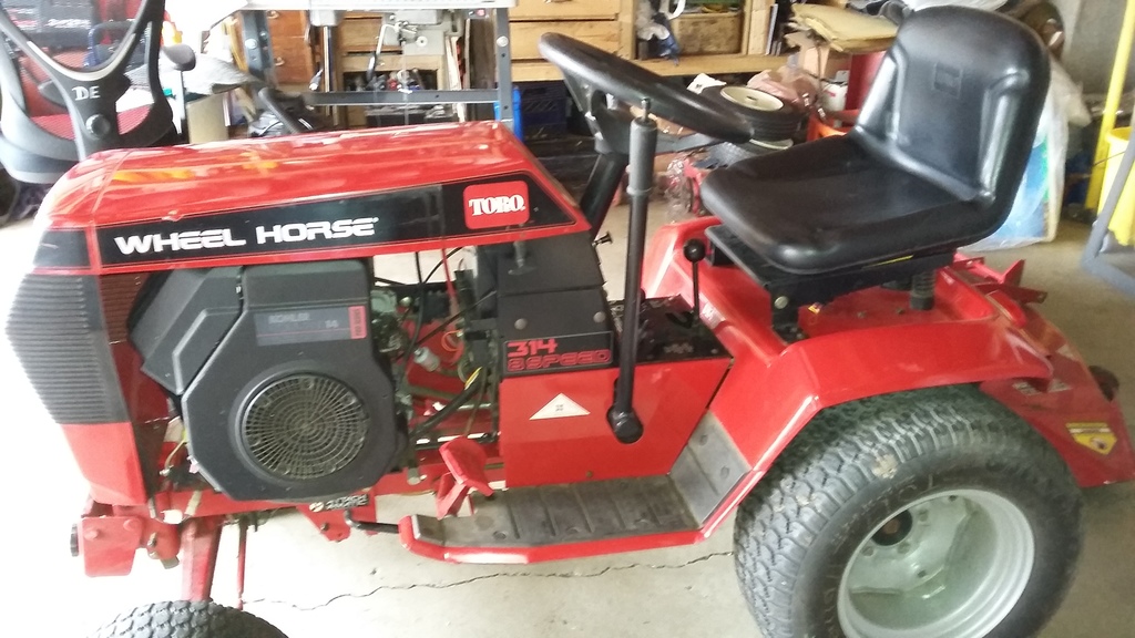

BOB ELLISON 2,980 #1 Posted March 9, 2017 (edited) I just said in my last post I didn't have room for any more tractors because my wife wouldn't have room to park her car in the garage. She's parking in the driveway now. I was searching craigs list Sunday and seen a post for a 314-8 for 200.00 it was 40 miles from me and I said to myself I can't do it. So I called him and said $200.00 and he said yep it's in storage , and I said where. Went and picked it up and it turns out to be a 2000 314-8 with a great 48" deck. It had 3 flat tires ,dirty carb,never been greased , dirty oil. So I changed oil with new filter,greased cleaned and cleaned carb, charged battery, inflated tires which I will replace all the tires. Put gas in tank and started it up . A little miss so I checked plug and it was loose . What do you think I told the wife ?? Honey it's my hobby that I love to do and she didn't say anything else.man I love that woman. Edited March 9, 2017 by BOB ELLISON added picture 14 Share this post Link to post Share on other sites
BOB ELLISON 2,980 #2 Posted March 9, 2017 Sorry I had to add a picture with the pully cover on. I forgot it in first two photo's. 10 Share this post Link to post Share on other sites

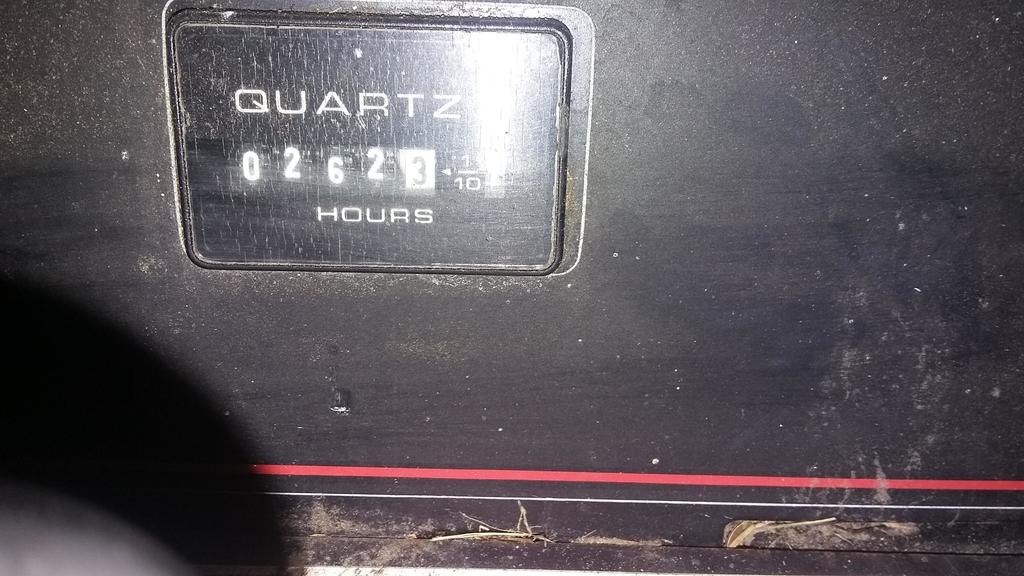

T-Mo-(Moderator) 4,496 #4 Posted March 9, 2017 262 hours! Nice find, very nice. 2 Share this post Link to post Share on other sites
BOB ELLISON 2,980 #5 Posted March 9, 2017 Just now, T-Mo said: 262 hours! Nice find, very nice. T-mo I didn't even look at the hour meter untill I got it home Share this post Link to post Share on other sites

can whlvr 993 #14 Posted March 10, 2017 that's a smoking deal,as we know that mower deck is worth double that alone 2 Share this post Link to post Share on other sites

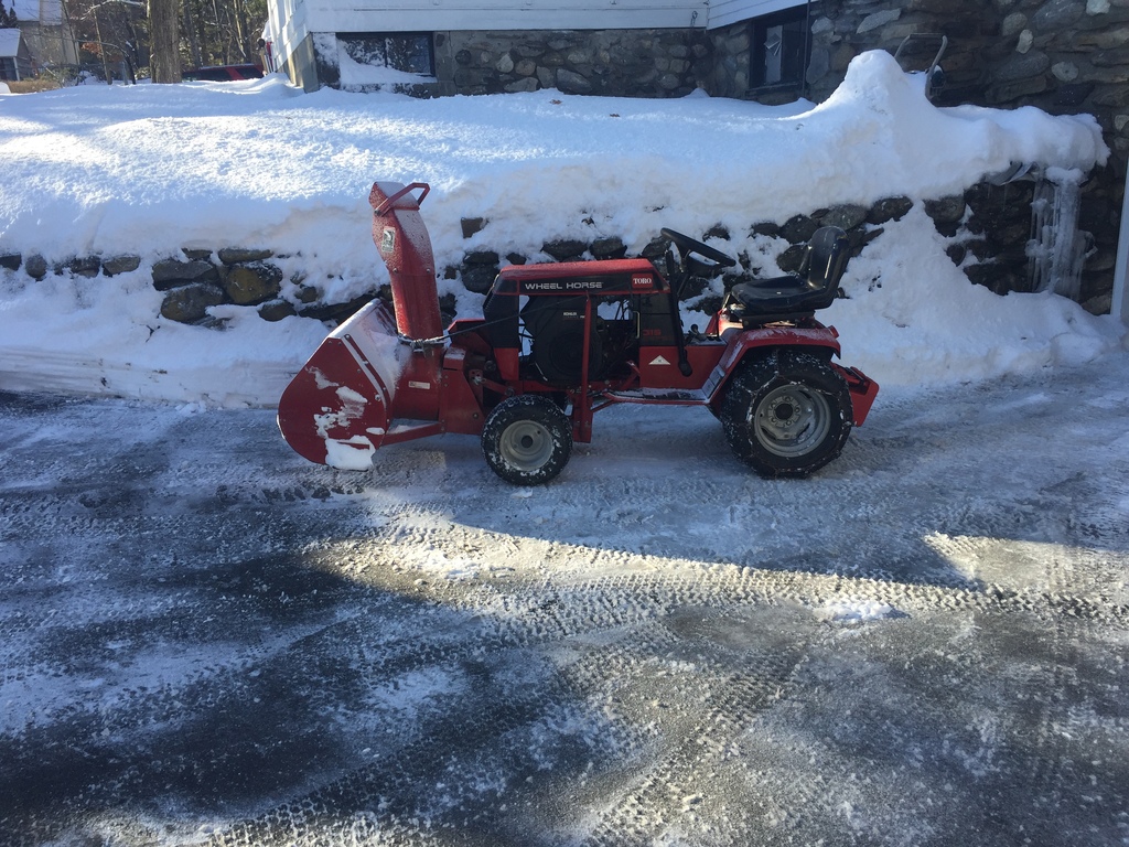

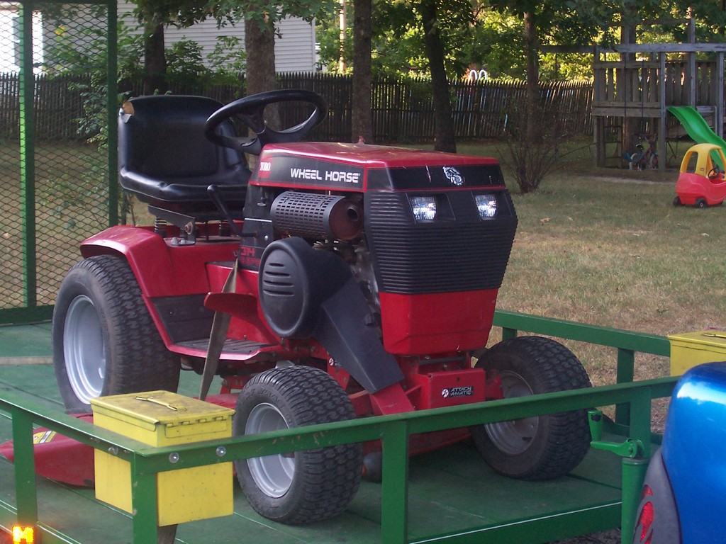

T-Mo-(Moderator) 4,496 #18 Posted March 10, 2017 I had a '98 314-8 with the Command engine, and a 48 inch deck. It handled the deck pretty well, except for heavy, tall grass, which is seem to struggle in. Here (was) my 314-8. 1 Share this post Link to post Share on other sites

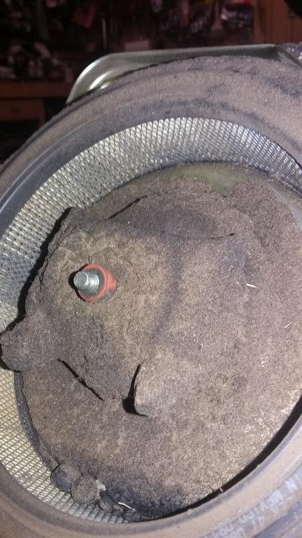

BOB ELLISON 2,980 #19 Posted March 10, 2017 Thank you guys @T-Mo @cschannuth and @bslms for all the info.when I started it I really like the sound of the engine. No smoke at all and it really purrs. The only thing I worry about is it didn't have the air filter cover on it so the carb was covered with grass. He didn't do any maintenance on this tractor. Oil was black and the seat switch was broken and i think that was the reason he parked it so I hot wired that switch to get it started. I will have to buy that switch. He said it has been in storage for 2 years. I did take a picture of carb and it was scary. I didn't pull the carb off just the bowl and sprayed off with carb cleaner. The little orange rubber is so the bolt will extend far enough so the cover can bolt on. He didnt figer that out. I had to change that to a tighter one now all is well. next is trans oil change. Share this post Link to post Share on other sites
Ed Kennell 37,997 #20 Posted March 10, 2017 That's one way to keep the filter clean. Share this post Link to post Share on other sites
BOB ELLISON 2,980 #21 Posted March 10, 2017 3 hours ago, Ed Kennell said: That's one way to keep the filter clean. It starts right up ED but I have to play the choke to keep it running I think I'll have to pull carb off and clean it really good. Other than that it's a very nice tractor. I'm going to clean the deck and put it on to see if it turns ok. But I have to wait for warmer weather. Cold here In michigan now. 1 Share this post Link to post Share on other sites

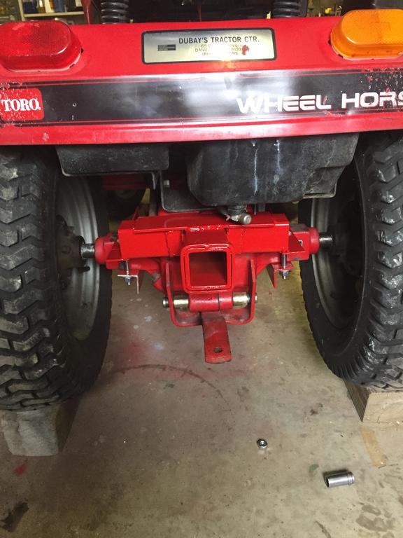

Red144runner 657 #22 Posted March 11, 2017 Nice 3/14. I have a 3-15 with the command engine and a lot more hours. Mine was not properly maintained either but luckily no permanent damage. I'll agree the command kohler is a great engine. Very smooth, easy starting too. Mine runs a 44" dual stage no problem. I did have to make a receiver hitch to hold my suitcase weights because with nearly 400lbs up front weight is critical 4 Share this post Link to post Share on other sites

Amcwheel85 2,059 #25 Posted March 16, 2017 You stole that for sure. Almost looks new! 1 Share this post Link to post Share on other sites
