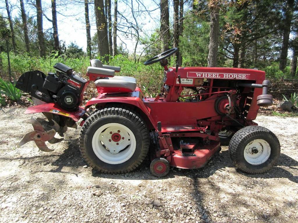

George Washington 67 #1 Posted February 7, 2017 (edited) ok - I bought my first Horse last night - It is a C-160 Automatic - I was going back and forth between it and a C-121 8 speed that was much cheaper - Now that I have the 160 Ive decided that I want the 120 as well. I'm thinking of swapping engines on the two so my hydro would have the 12hp motor and I could use it just for mowing and then my 8 speed would have the 16hp Kohler and I could use it for bigger tasks - Does anyone have an opinion on this? It makes sense to me on the surface but am I missing anything? So I would be taking a C121 8 speed and a C160 Hydro and making a C121 Hydro and a C160 8 speed here is my new C160 Edited February 7, 2017 by George Washington my bad 1 Share this post Link to post Share on other sites
