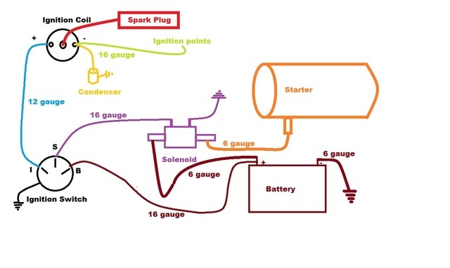

My new horse has no spark, so I removed the gas tank to have a look at the wires going to the dash. The starter circuit runs right through the switch and it seems like that might be asking a lot of a 48 year old unit. I am thinking of adding a solenoid and using the switch to trigger it. I am also thinking that adding a fuse or two might prevent some magic smoke as well.  The Kohler has points ignition is about all i know for now, but I would be grateful for any guidance in finding a wiring diagram for the 1956 Electro 12

Here is a basic wiring diagram, a fuse could be added to the wire from the ignition switch to battery.

The tractor is a Raider with hood decal that says Electro 12. Model# 1-7235. engine K301-S  I was told that it is a 1968 model ,but not sure about that.  The switch has first position 'off and remove key'    2nd click [accessory? like the cigarette lighter?]  3rd click--i am assuming ign., and 4th click start.. a heavy wire feeds direct from the battery to the switch, and another heavy wire feeds from the switch direct to the starter+ post.
 The second wire feeds from the switch to the points and condenser, and a third wire feeds from the switch to the cigarette lighter.
 Two wires feed out of the cigarette lighter  One goes to the electric clutch and another to the rectifier. I got back as soon as I could, but am already late for an appt.

Sounds like you have a magneto system with points.  The wire from the ignition to the Points condenser is a kill  (grounds out the ignition to turn off motor.)  If you replace the ignition switch make sure you get one for a magneto system otherwise you may fry your mag.

There really isn't much in the manual about diagnosing mag systems.  They sort of work or they don't.  Disconnect the kill wire, (The one from the ignition switch to the points/condenser.  The switch may be bad an grounding the system all the time.  Also make sure your points are clean and opening/closing.  For the test also disconnect the condenser.  (Lets eliminate potential issues).  if you still have no spark the mag is probably toast.

 The wheel Horse site states that the ignition system components are incompatible between the three systems used in the ignition on the k 301, I tested the condenser by switching the unit to the other tractor. Works OK. So now we are down to cleaning the points or maybe just replacing them. The system on my tractor utilizes a mag that is controlled by the points. That is all there is. Mag, points , and condenser.[no coil] i think the tractor should run without the ignition switch hooked up if it is good. Not optimistic at all that it is a good mag.
