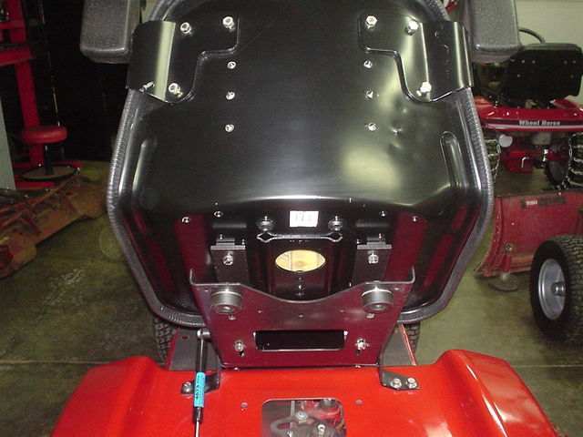

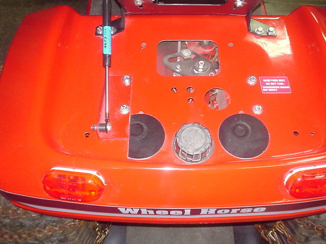

Those coil springs are just for the seat switch. If you remove it or it does not work then you can take those off and just leave on the rubber pads.
As for the gas spring that holds the seat up, use a Strong arm F4673. You can get it for much less than the Toro one and it works as good if not better.
