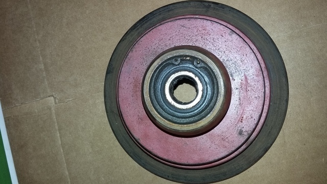

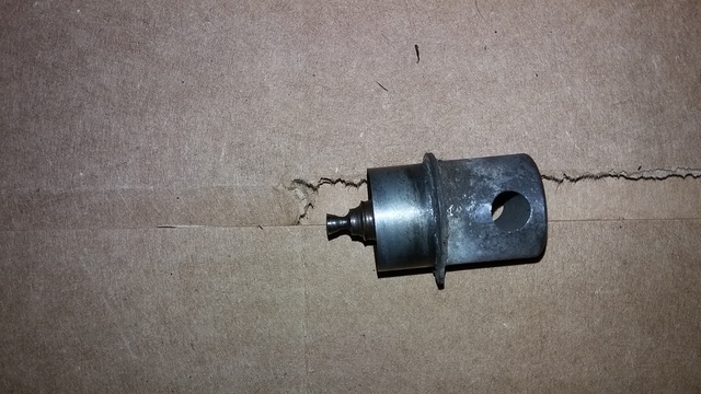

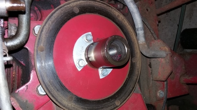

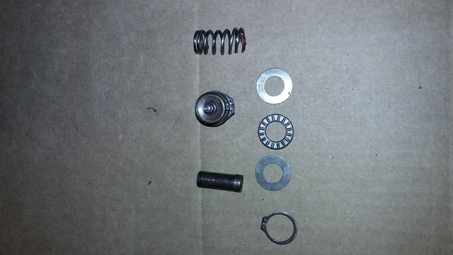

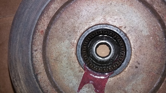

BOB ELLISON 2,981 #1 Posted April 16, 2016 Sorry guys but I need input I have looked high and low for all the information I could find on this subject rebuild diagrams or assembly diagrams for pto clutch. I have been looking for help for my 1977 B80 pto clutch . Started to remove it to check for grease and found like others posted a spring, 2 washers, a thrust washer, a shaft-pto , and a 7/16 stud laying inside of pto. but I looked at all the diagrams and can't find one like this shaft-pto . from the b80 .the diagram says it should have room for 2 snap rings one out and one inside. This one doesn't have a place for a snap ring on inside.it pulls right out with very little effort there's no way it will hold that spring in it would push the pto shaft out pto-t out. I did read a post by Rmaynard about taking all that stuff out and adding a shaft-pto 102872 and 2 snap rings 936125. just a few questions guys will a pto from a 1977 c160 work on the b80.i removed the one on my 1974 c160 and it looks different then the b80 pto. and does that 7/16 stud screw all the way into the crank tight. the 1st and 2nd pictures are the pto-shaft Share this post Link to post Share on other sites

BOB ELLISON 2,981 #3 Posted April 17, 2016 Thank you daveoman1966 I did find that diagram and the part numbers as you posted. But did you ever see that type of pto-shaft ? There was a snap ring with the other parts in the pto stuck in the grease. There is no way that snap ring came off that pto-shaft. I do have a pto on a 1977 c160 k341.will it work on the b80? ? Thank you Share this post Link to post Share on other sites
daveoman1966 3,873 #4 Posted April 17, 2016 The PTO from the C-160 should fit w/out mods and you'll probably need to swap over the clutch disc too.... Use the bearing race for the B-80 . Share this post Link to post Share on other sites
