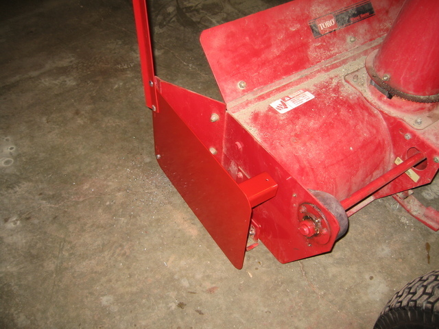

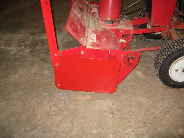

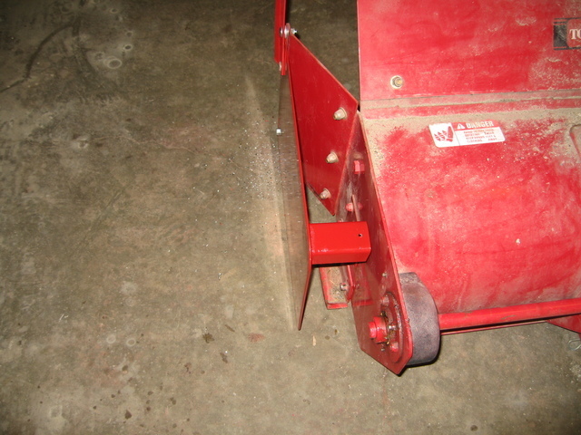

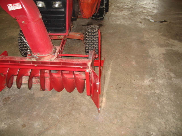

Shynon 7,475 #1 Posted January 3, 2016 Thought I would show my snowblower wing extensions I made. Helps keep tractor going straight and not getting sucked in. 12 Share this post Link to post Share on other sites

Ed Kennell 40,373 #5 Posted January 4, 2016 Nice work....great idea to improve steering control. Have you had a chance to test it out? Please let us know. 1 Share this post Link to post Share on other sites

Shynon 7,475 #7 Posted January 4, 2016 Drift cutters are Ariens, and yes I had these wings on a wheel horse snowblower about 20 years ago and they worked. 1 Share this post Link to post Share on other sites

cleat 6,944 #9 Posted January 4, 2016 Makes it straight down the side like the 2 stage. I was blowing ice crystal snow around 4" deep capped with a layer of ice a few days ago with it. Problem with that one is the blower wanted to push back into the already blown path. Better in that it did not get you stuck but it took a few tries to get the sides done. I have not tried ou the single stage yet, but if it pulls you into the snow that could be a problem for sure. Your sides look great BTW. Cleat 1 Share this post Link to post Share on other sites
JC 1965 1,532 #10 Posted January 4, 2016 Great job, I can see where that would help. Looks like you have the extensions supported very good also. Thanks for sharing. 1 Share this post Link to post Share on other sites
shallowwatersailor 3,214 #11 Posted January 4, 2016 Interesting modification and nice fabrication. I have thought of using a drift cutter like what European snowblowers have. It is a square hoop that projects out that cuts into the drift. I haven't noticed that reaction though with my 523Dxi and the single-stage snowthrower. The additional ront end weight that I have could be factor 1 Share this post Link to post Share on other sites
