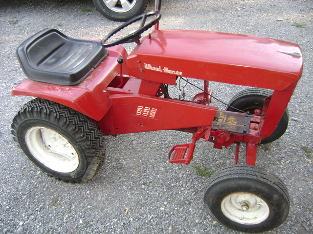

Can someone tell me what year this tractor is , no motor but looks like all the parts are there , model # T656 , serial # 255638 , and what size motor was in this

1966 would of had a 6hp Tecumseh
Sent from my XT1080 using Tapatalk
By the looks of that plate on the frame someone has had a different motor on it at one time

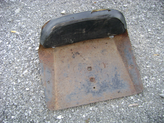

Thanks for the info , for the money I just couldn't let this one go , it even came with the original seat , the seat pad is missing but it has the back

jimkemp  :WRS:Nice looking 656. There are still a few HH60`s around if you would like to keep that way. It looks like it is all there. I Have the bottom pan so if you would like to have it made up can send picks of the size and length. Just so you know the 65`s and  66`s that I have seen the seat is white in the middle. This is what I have seen.  My 606 that I had was white. Enjoy the ride. Gary  B.... Edited by T1257

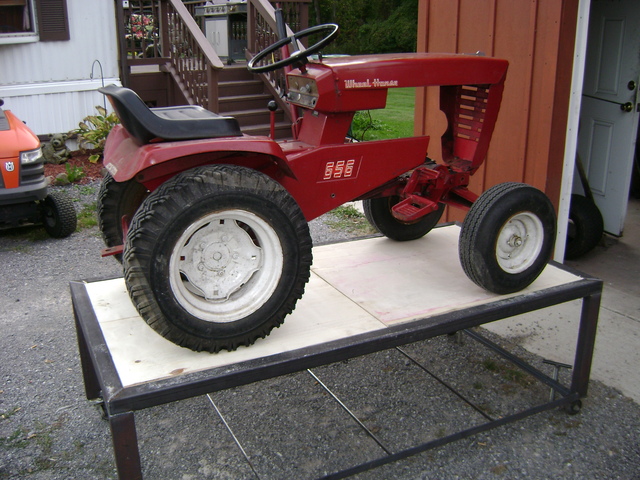

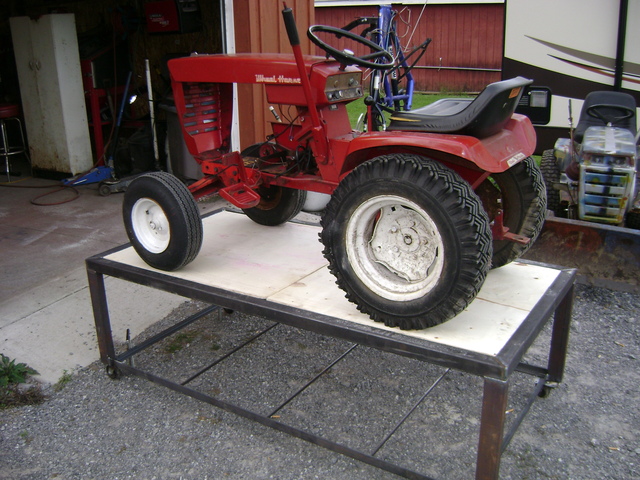

Well I wanted to start working on the 656 today but didn't feel like bending over to do it so I built this so I don't have to , still have to add the expanded metal to the bottom for storing parts as 2015_tractor_stand002.thumb.jpg.35ff22162015_tractor_stand001.thumb.jpg.74d01874
