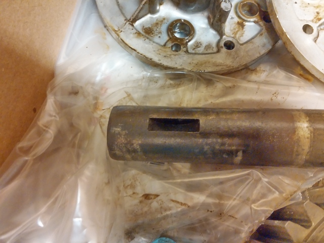

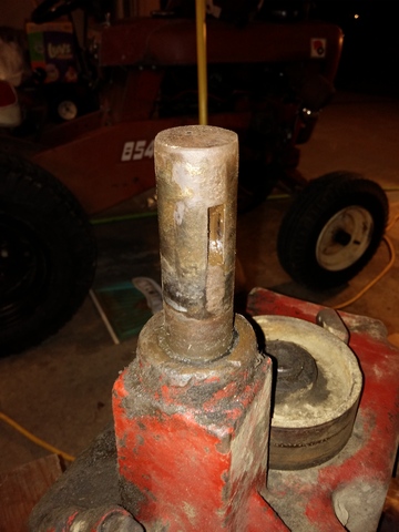

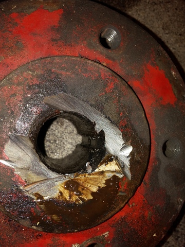

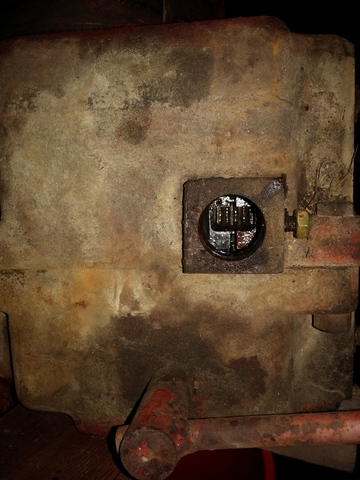

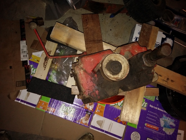

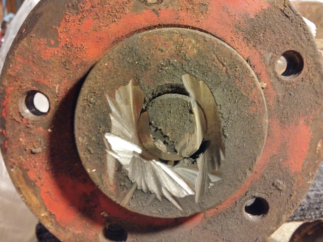

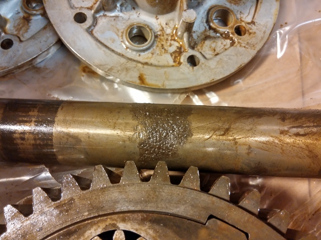

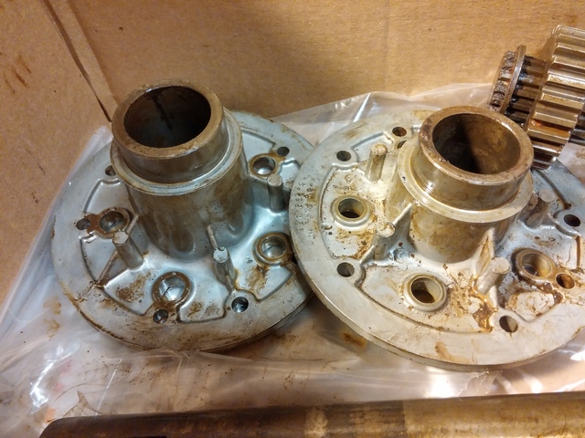

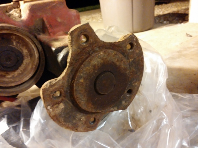

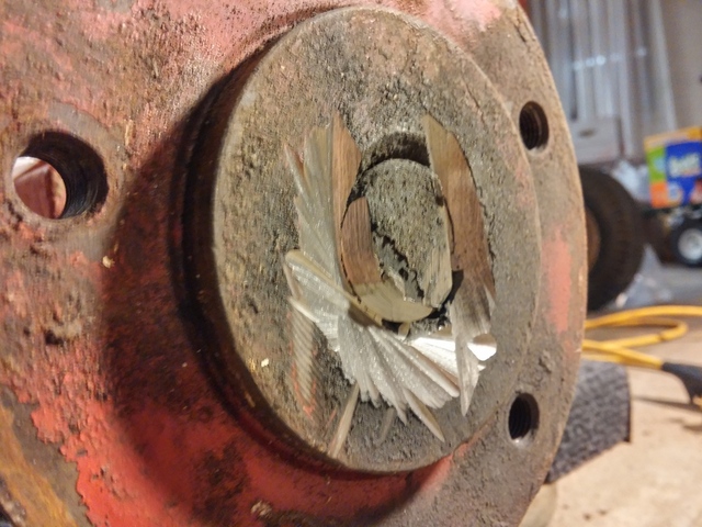

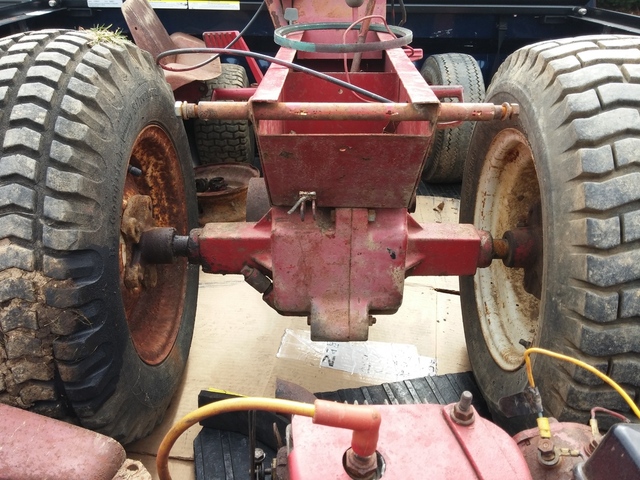

bmsgaffer 2,046 #1 Posted July 16, 2015 I was hoping to put an 8 speed transmission on my 854 mostly for the limited slip diff, but it would be nice to have low range every once in a while. Before I knew anything about the differences in transmissions (input shaft/pulley size especially) i happened upon a pretty trashed 867. The transmission shifted smoothly into all the gears and I got it for a song (was at the persons house 3 hours after listed on CL!) so the adventure began.I learned after the fact that this was an excellent bit of luck as it was the only year of 8 speed to have the right input pulley to match up to the engine pulley on my 854!Got the rest of the 867 dealt with a few months back and never had a chance to really take a look at the transmission until tonight. I knew that one hub was welded on the axle and the other was busted up so I preemptively bought good used replacement axles and I have hubs from a C-165 I can use.Ground off quite a bit of really ugly weld, had to bite into the hub and axle a fair amount.Broken hub (with a leaky seal behind it, maybe an early attempt to replace?)Got both hubs off without too much effort... Well the axle keyways look... perfect.. what!? Lets check the hub...WTH!? Keyway is also nearly perfect... whoever welded this was a nutcase. I had to ruin the hub and axle to remove it.Was this a setscrew originally? Looks a bit cobbled.I had mixed in a bit of pure methanol to clean out the oil... Dumped out a gallon of mostly water. No oil to be found.All setup on my 'work station' ready to be torn into.To Be Continued... 7 Share this post Link to post Share on other sites

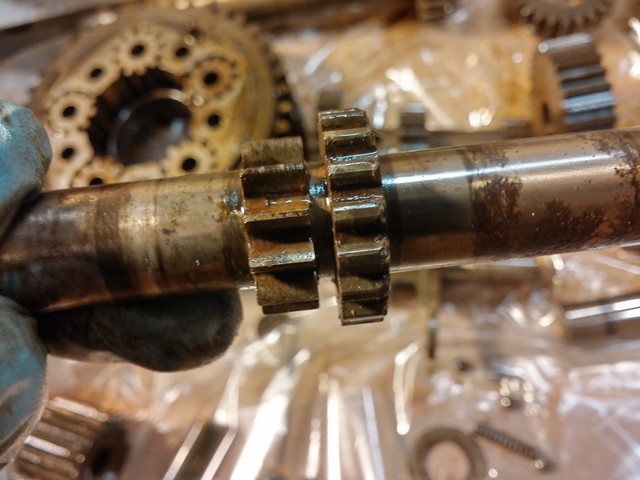

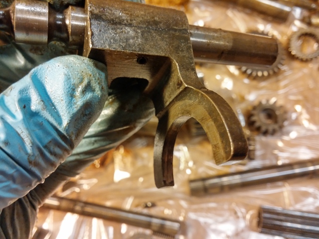

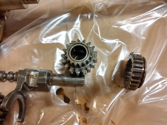

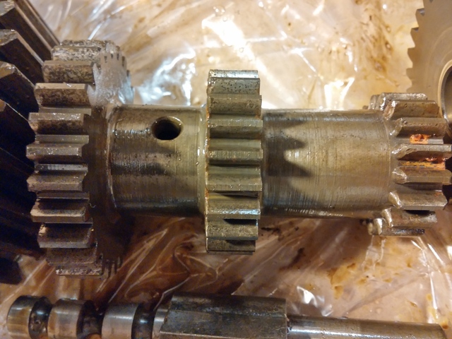

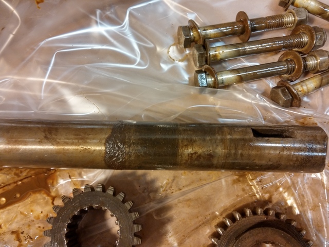

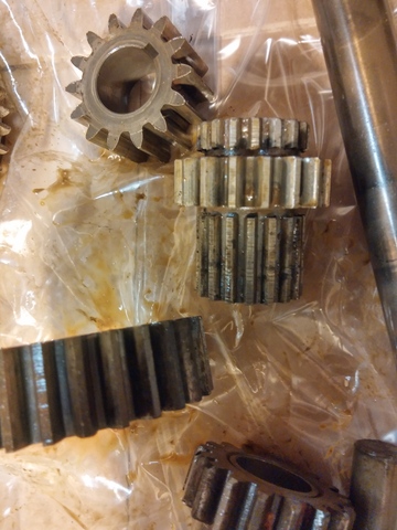

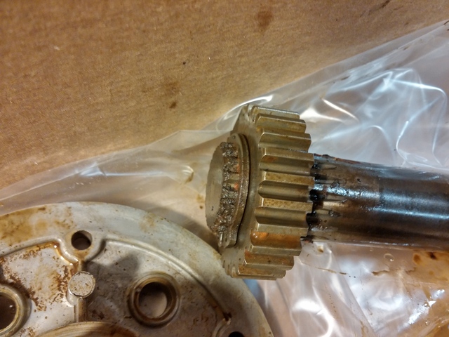

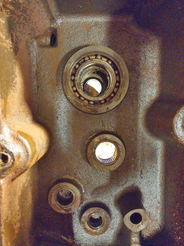

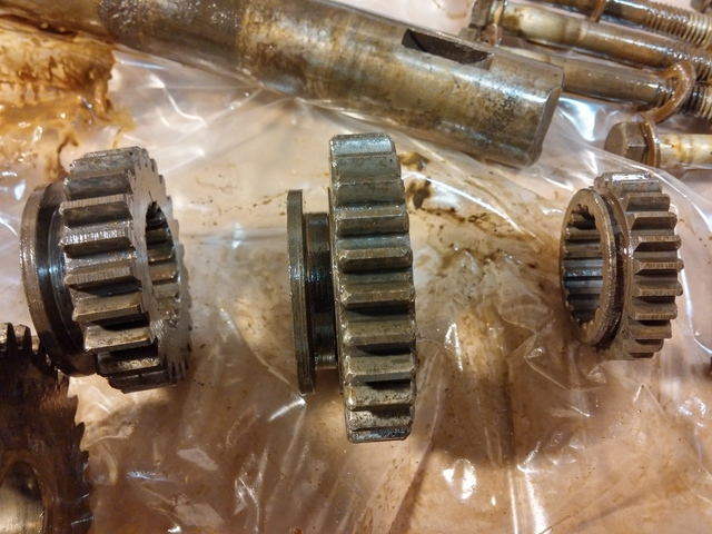

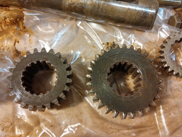

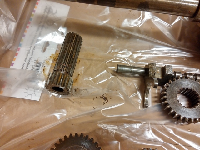

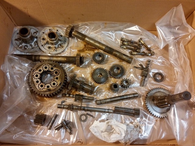

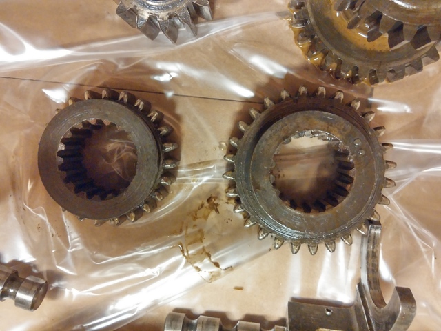

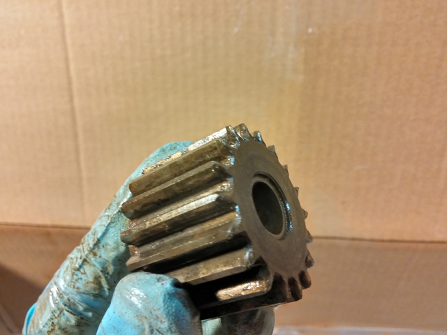

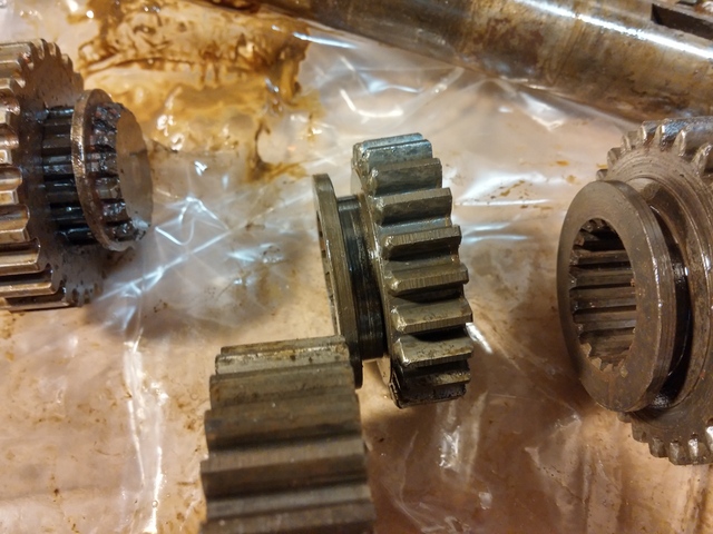

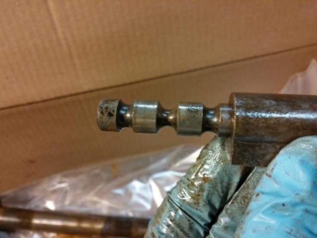

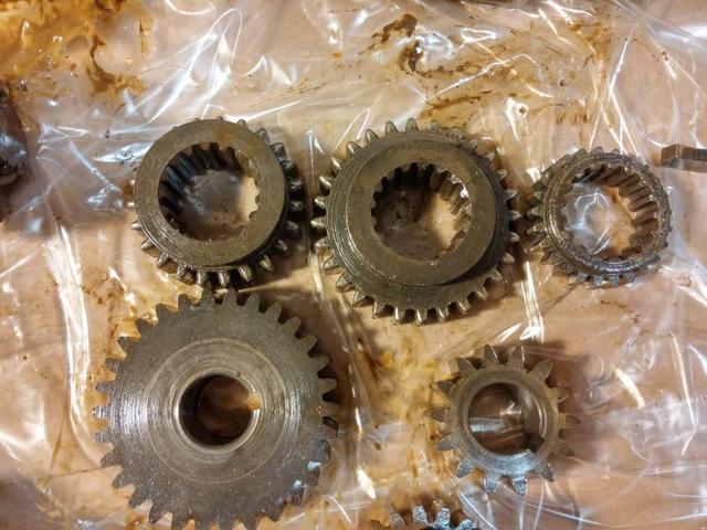

bmsgaffer 2,046 #5 Posted August 14, 2015 (edited) So I finally broke into this tonight. Came apart with ease, which was surprising for a 48 year old tractor. I THINK the gears look REALLY good:Which is awesome. The pros will have to take a look and let me know if they see anything that I dont. But I was impressed with how it looks for its age!THEN i found this: Of course I would loose a 1533 and the needle bearing at the end of the axle. I dont have a press or anything and I was hoping to not have to dig into bearings. Everything was spinning smoothly, or so I thought.The other side doesnt look too bad, the brake shaft needle bearing might be a bit stiff.Thoughts? Edited August 14, 2015 by bmsgaffer 4 Share this post Link to post Share on other sites
stevasaurus 22,968 #6 Posted August 14, 2015 The transmission gears do all look real good. All of the needle bearings will tap out with a good brass or steel punch...some times, I can pop them out with the right size 1/2 drive socket and an extension (put the extension in the socket from the inside...ie...use the back of the socket as an arbor). I have had luck popping out the #1533 bearing with an air chisel...hit the trigger once and she pops right out. They do make a bearing puller that you may be able to buy at someplace like Harbor Freight....we have some threads on the puller. Mike (racinfool40) does have good, used #1533 bearings...and he will sell you one if that is all you need. Send him a PM.Open up that 10 pinion differential, ya big chicken!! Looks like you have the aluminum caps differential. If there is anything that is not good in that trans...it is in the differential. Don't forget to replace those nuts when you put the differential back together. 3 Share this post Link to post Share on other sites

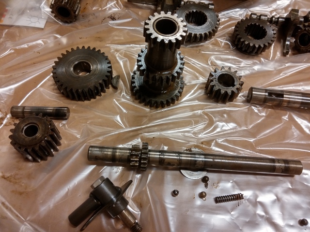

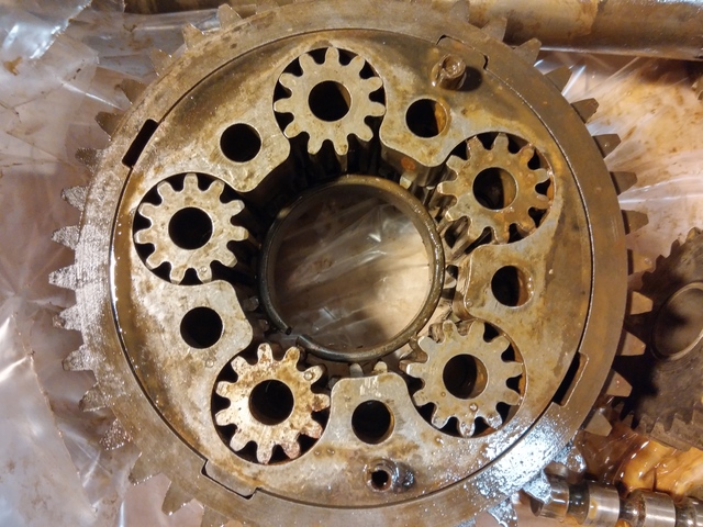

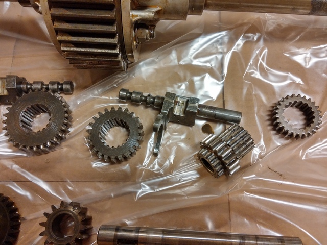

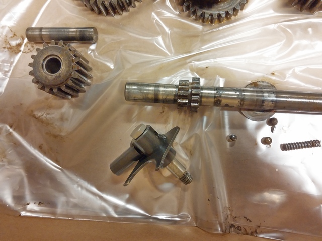

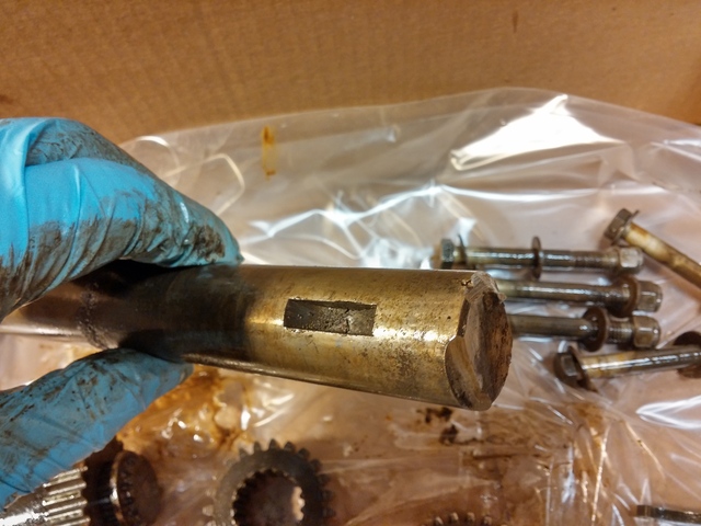

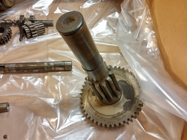

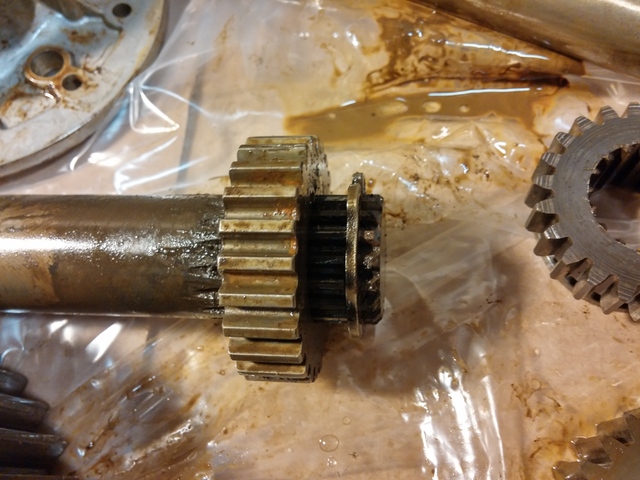

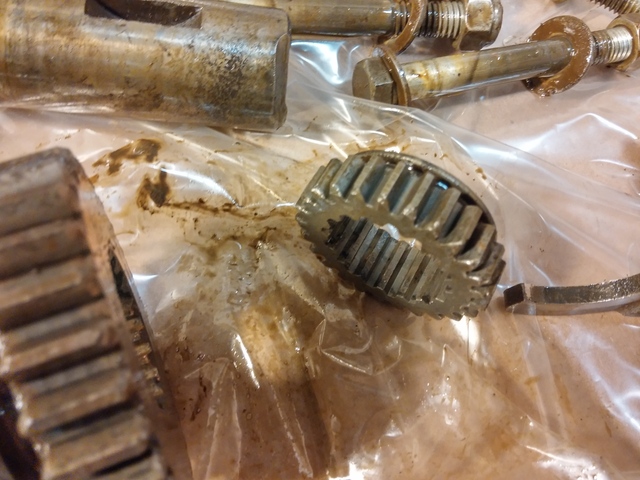

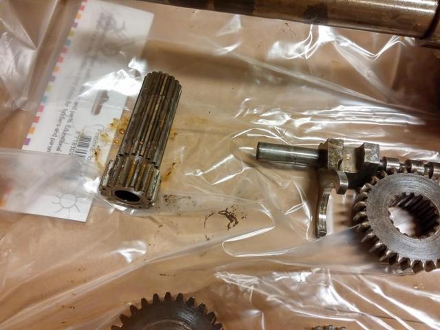

bmsgaffer 2,046 #10 Posted August 28, 2015 Finally had time to pop the diff apart (5 bolts, you would think it would take less than two weeks, yet here we are). And no, I have no plans on popping that spring ring out and making any futile efforts to replace it, all the diff gears look great . Added some more detailed pictures of the gears. Do the gear experts still think all the gears and axles look good enough to reuse? I bought pretty nice spare axles in the spring, but I think the key ways on the existing ones are even nicer. Would you replace them or not (forgot to get pics of the replacements but they have less pitting but JUST slightly more worn key ways.I am just going to order the 1533's from @racinfool40 Mike today if so and try to find some replacement needle bearings. 4 Share this post Link to post Share on other sites
racinfool40 202 #11 Posted August 28, 2015 I wouldn't have a problem re-using any of those gears and the axles...a good clean up and back on the road!! 5 Share this post Link to post Share on other sites

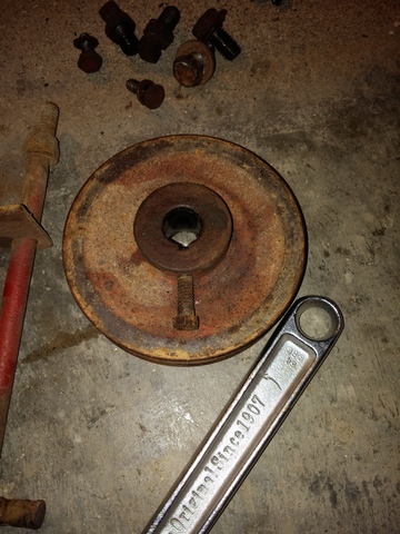

bmsgaffer 2,046 #13 Posted September 1, 2015 could you please explain the input shaft / pulley differences you were able to avoid by using the 867 transmission over any other model? I will do my best! Michael Biser @racinfool40 helped me out with it a while back.First off, the early tractors 1967 and earlier with 8hp or less had 2" engine pulley and 4" transmission pulley. Later tractors have a larger engine pulley and thus a larger transmission pulley (6.25"). 8 Speeds were only used with the small pulley for one year (1967).4 speed transmissions have 3/4" input axle shaft. 8 speeds have 5/8" input axle shaft. So the pulley that is necessary for an 8 speed conversion on any early tractors was only available on 1967 tractors, but (i THINK) if you found the right pulley you could use any newer 8 speed.So, really, as far as I know the only thing that was truly beneficial was that this transmission came with the right size pulley. When I put the rest of the 867 tractor up for sale for parts I had more than 10 people contact me about the pulley. 1 Share this post Link to post Share on other sites
Pullstart 63,542 #14 Posted September 1, 2015 gotcha, so in theory a corrected engine pulley in 2:1 ratio might net the same results, but then the drive belt will all change size as well. thank you for the clarification! Share this post Link to post Share on other sites
bmsgaffer 2,046 #15 Posted September 1, 2015 Oh and the belt profile on the older tractors is the smaller 1/2" i think, then they went to the 5/8 belt. I think! The biggest issue is fitting the belt in the original belt guard, which doesnt fit for anything bigger than a 2" pulley. Share this post Link to post Share on other sites

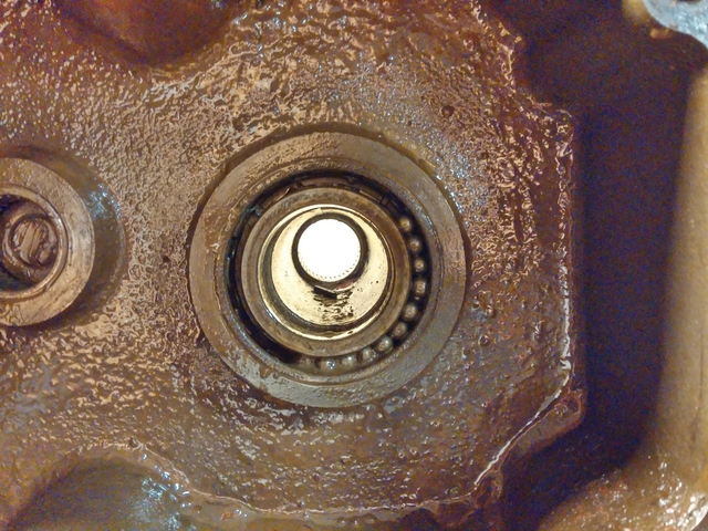

bmsgaffer 2,046 #16 Posted October 8, 2015 OK. I need some help.The one 1533 bearing that was busted fell apart as I was trying to remove it. Now the outer race of the bearing is firmly planted in the transmission case and I cant seem to get anything of substance in behind it. How do I get it out?Any ideas? Share this post Link to post Share on other sites
gwest_ca-(File Mod) 11,177 #17 Posted October 8, 2015 (edited) Got an ark welder? Run a heavy bead around in the ball groove and when it cools the bearing will fall out.GarryAdding - The last couple I did I used a mig welder set at the high end. If the race turns red hot you got it right. Edited October 8, 2015 by gwest_ca 3 Share this post Link to post Share on other sites
bmsgaffer 2,046 #18 Posted October 9, 2015 Got an ark welder? Run a heavy bead around in the ball groove and when it cools the bearing will fall out.GarryAdding - The last couple I did I used a mig welder set at the high end. If the race turns red hot you got it right. Welder! That big expensive thing I have on my shelf for occasions JUST like this... I'm a relatively new welder owner and I forget the wide range of uses for this wonderful machine. I went right out to the garage, hooked up my trusty Hobart Handler 140, did just as you suggested (though I had to knock it down one from the highest setting as I was getting close to going right through) and after once around it just took a light pry from the bottom and POP, it came right out.THANK YOU Garry! Now there should be some more progress on this thing this week. Stay tuned! (although it is just really another transmission rebuild... ) 3 Share this post Link to post Share on other sites
