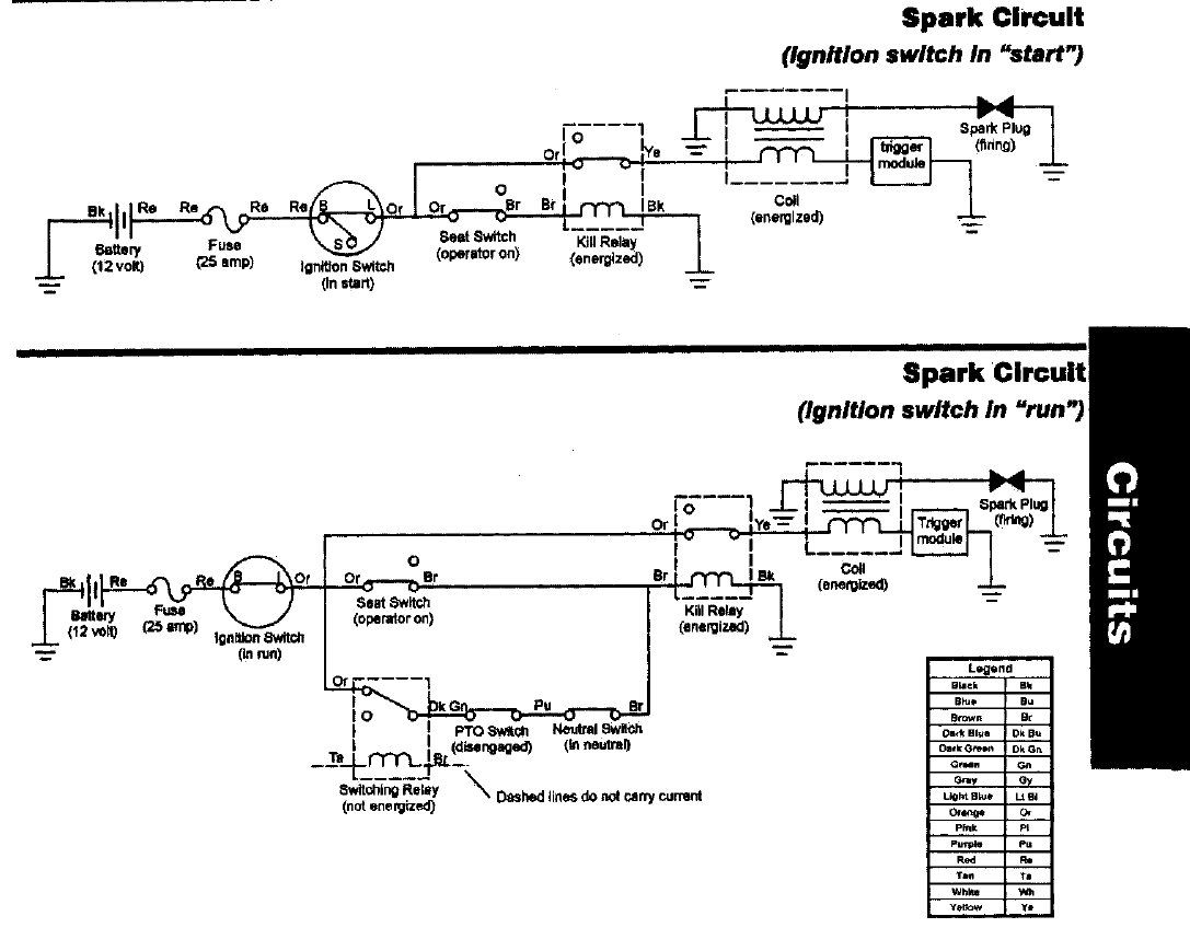

rmaynard 15,892 #2 Posted June 1, 2015 Could be either one, but first, what is the year of your 520-H. Here is a wiring diagram of the spark circuit for the 1991-1997 models. There are a couple of things to check first. Check the 25 amp fuse, and make sure that the seat switch is being activated, the PTO is disengaged, and the motion control lever is in neutral. By looking at the diagrams below, any one of those plus a bad ignition switch, switching relay, kill relay, trigger module or coil could be at fault.But always check the obvious stuff first. 1 Share this post Link to post Share on other sites

shallowwatersailor 3,214 #8 Posted June 5, 2015 (edited) My '89 520-H started in the winter after I got it and then wouldn't start in the Spring. Played with it off and on all Summer with the wiring diagrams, but nothing. I finally changed the ignition switch that was suggested to me by two people and - voila! It ran. Edited June 5, 2015 by shallowwatersailor Share this post Link to post Share on other sites
doc724 925 #9 Posted June 5, 2015 Hi John,Thanks for this tip (bad ignition switch). I will add it to my diagnostic "tool kit" on the "other 416H" I have. Share this post Link to post Share on other sites
