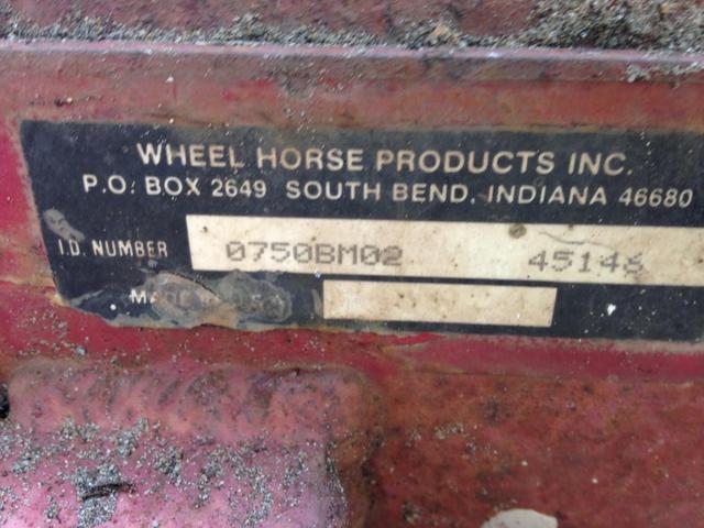

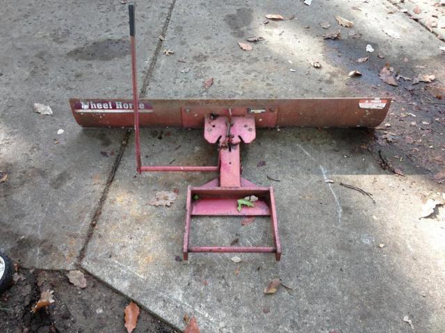

Dhodge 528 #1 Posted October 6, 2014 Hi everyone. Can anyone tell me if the 50" mid mount grader blades fit the D series tractors? I have a 0750bm02, 45146 grader blade that a gentleman wants to purchase off me to put on a D series horse. Thanks in advance. Denny Share this post Link to post Share on other sites
gwest_ca-(File Mod) 10,496 #2 Posted October 6, 2014 07-50BM02 fits C-Series except C-195 and 300, 400 and 500-Series and sold 1986-1989. 7-1121 . and 7-1122 fit the D-Series Auto models Garry Share this post Link to post Share on other sites
