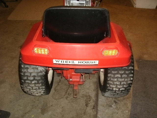

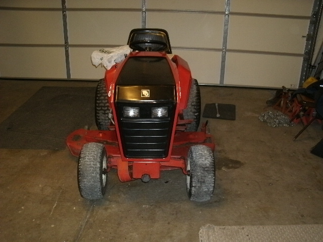

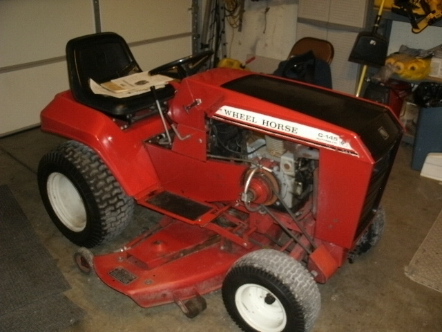

vinnyfish1 9 #6 Posted October 5, 2014 Thanks for the replies .... the fuel pump works great it just seems a little rich cold .....but I think that is normal for older machines ......I think I have just got use to the newer ones that run so lean....I am still learning how this old girl,s sounds , smells , and how it feels win my butt is on the seat .....I think you are right m-bailey on the fuel pump,,,, added somes pics picks for J-hawg 1 Share this post Link to post Share on other sites
