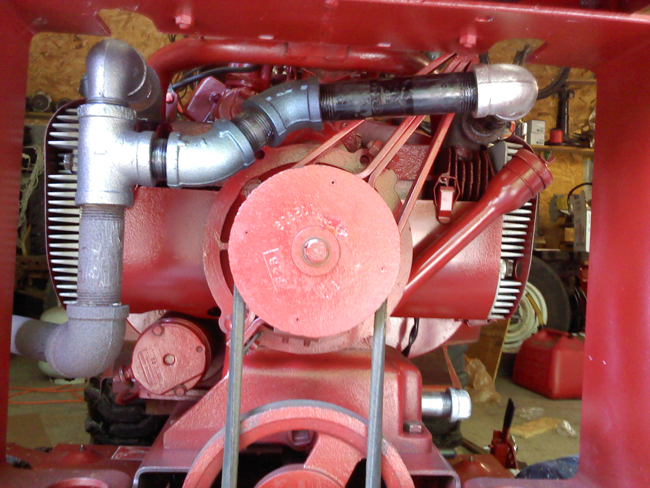

buffcleb 2 #1 Posted May 27, 2014 (edited) We have an 18 Auto that hasn't got much use... this year we started it back up and wanted to use the tiller we got with it... We have never used it before... The PTO seems to not be disengage... I have to feather the engagement lever in order to keep power... I have tried to adjust it but am not able to get it right... The lever from the pulleys also seems to flop down to the side... I did a youtube video showing what its doing There is plenty of clutch material so I do not think that is my issue I have some pics of the PTO here https://www.flickr.com/photos/89866486@N02/sets/72157644435834760/ Looking at the video I think I am going to do another on my next trip down to the cabin with my camera facing the PTO... might provide more insight Edited May 27, 2014 by buffcleb Share this post Link to post Share on other sites

alswagg 128 #17 Posted June 9, 2014 Is your PTO belt tight? Seem simple, but it is easy to tension correctly. In your first picture, I noticed the belt was not on the pully correctly. Hmmm maybe a simple problem. The belt should go on the inner grove on the crank pulley and then go to the larger PTO pulley shaft. This will generally give a .5 ratio PTO to crank rpm. Al Share this post Link to post Share on other sites
buffcleb 2 #18 Posted June 9, 2014 I got it back together... and tilled... then the coupler between the PTO and tiller lost the ball bearings that held it in place... more fun did a video of me putting it back together and the tilling... that was fun... I first drilled and tapped it for 3/8... which was wrong... had to go and get a 7/16 tap... a note the auto-zone taps are awful... but it was the only place around... I got the pivot in... I am going to replace the clutch surfaces this year... but at least its working... After this run I swapped in a newer coil and re-gapped the points... they were way tighter then .020... maybe .015... they looked good though... You can also see in that video the level of smoking I get... a little on startup... then it clears up... on that cylinder (left side if sitting on seat) the valve cover has some oil seep on it... so I'm thinking the valves are leaking... I'm going to do a compression test next weekend... and try a leak down test... I want to get a new gasket for the valve cover before I open it up... 1 Share this post Link to post Share on other sites
