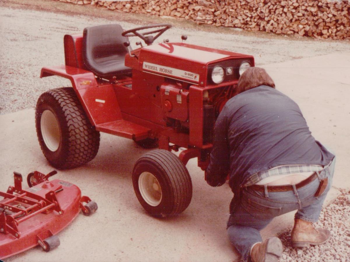

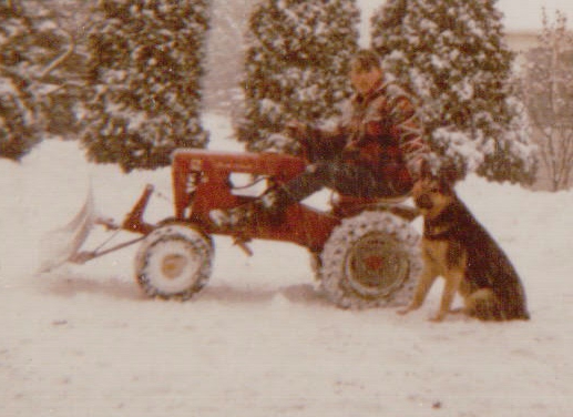

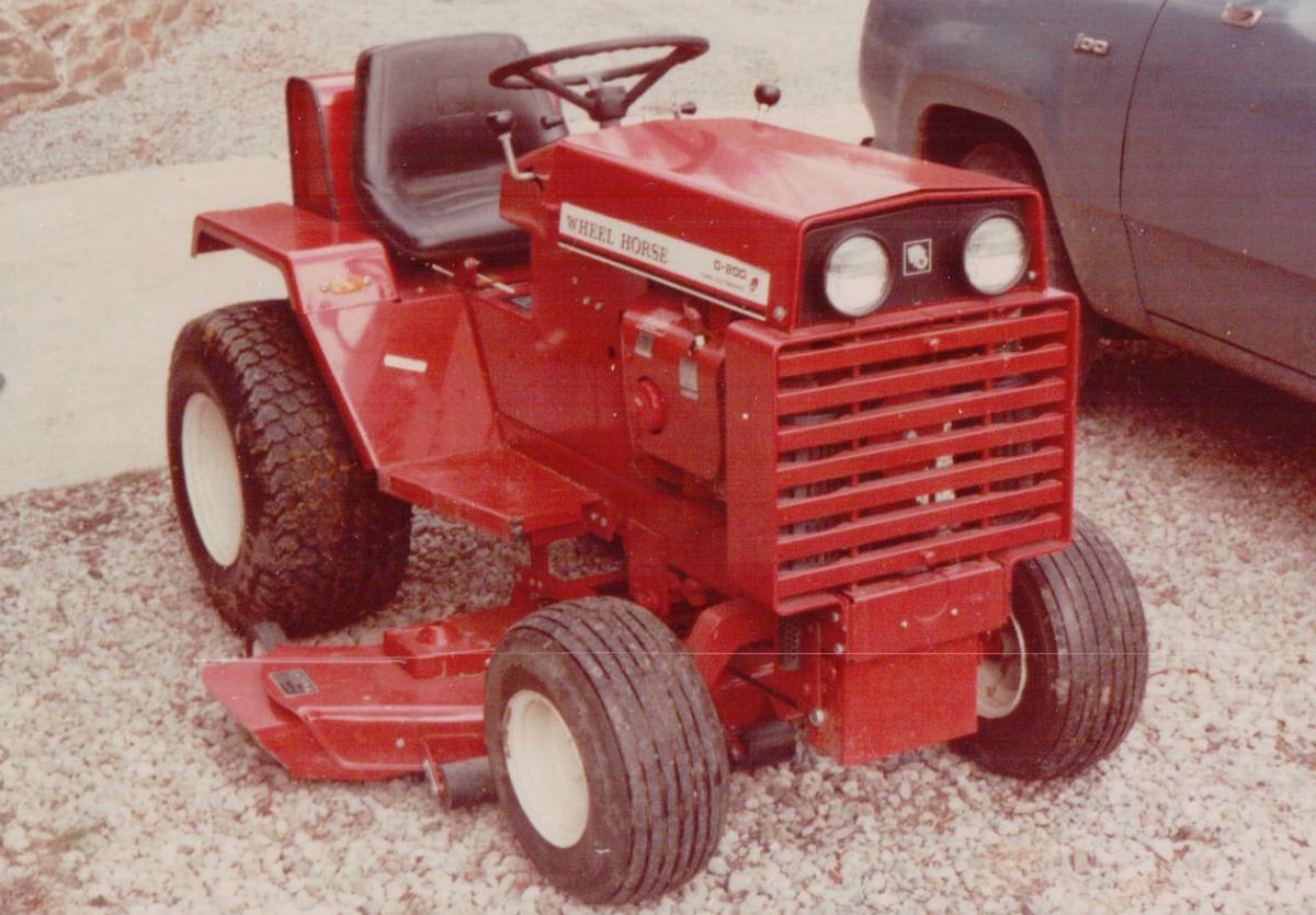

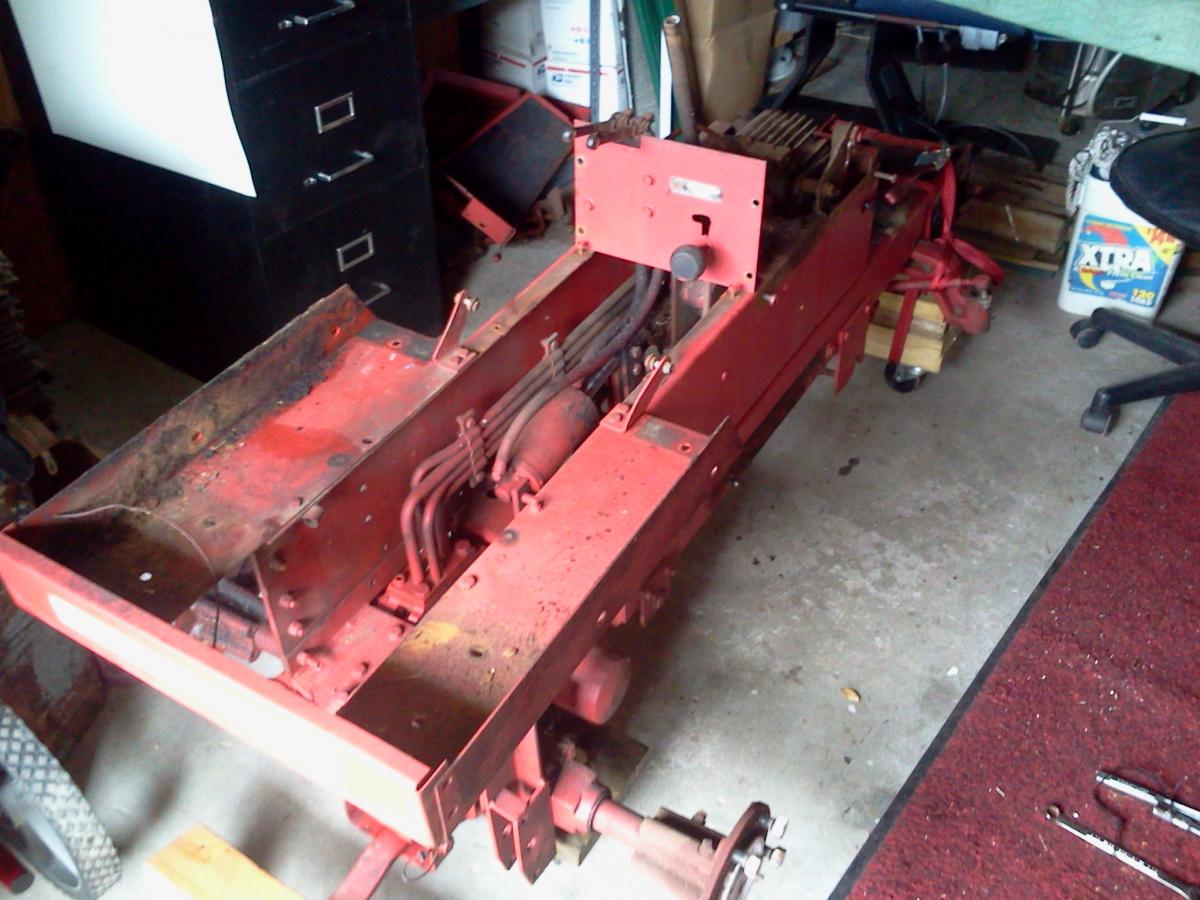

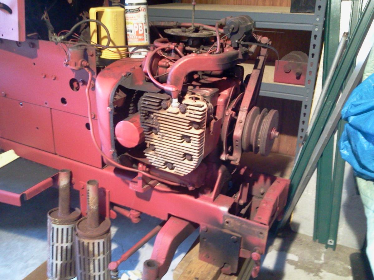

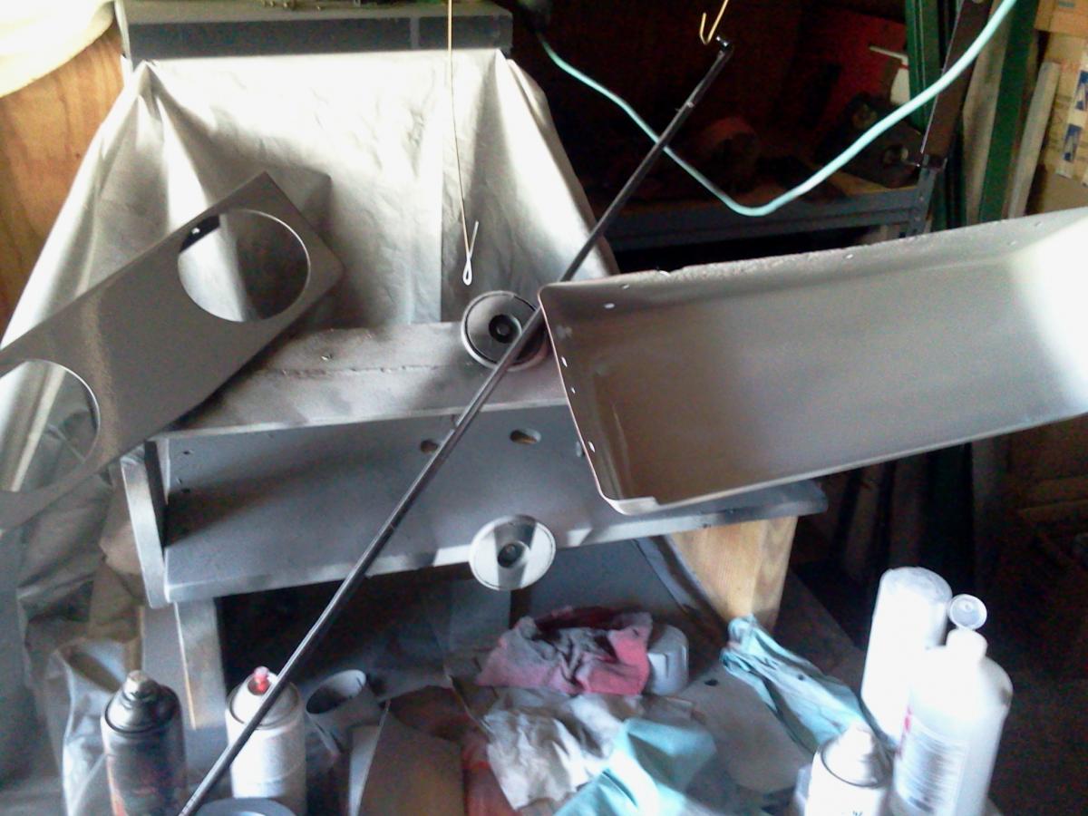

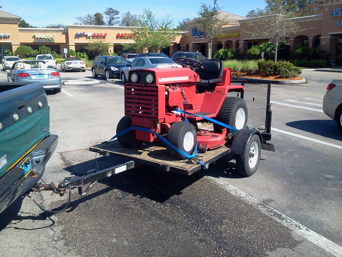

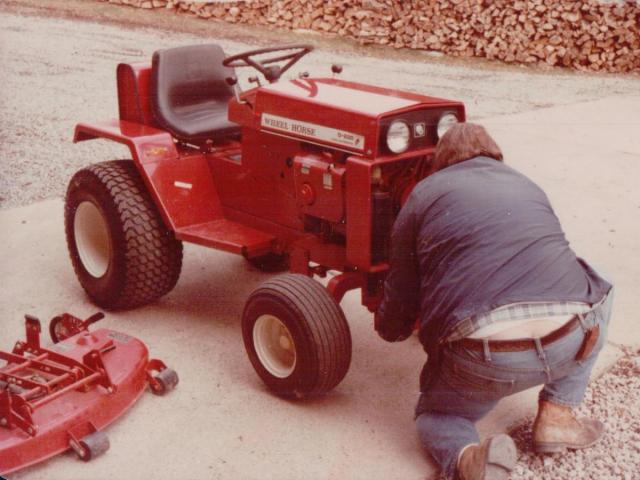

rtfbg 744 #1 Posted May 17, 2014 OK ... I'm sorry!!!!! I got yelled at because I had no idea how this worked. I just jumped in with both feet, and I guess I should have read a bit first. So ... I'll start over on my own post, and not trash up other guys stuff!!! Background ... in 1978, I got a new D200 for my Dad at Jacks Wheel Horse in Sarver PA. First two pics are when it was new, one nice pic, one with my big butt in the middle of it!! Over the years, it was used to mow, plow snow, and spread lots of gravel and dirt. One hell of a machine, period!! It also served Dad well as a grandchild entertainment device!! It replaced an older 6hp horse, which we worked to death. One pic here is me pulling a single plow with Dad steering , or should I say LEANING on it!! Even with all his weight that lil 6 pulled it!! So fast forward to 2014 ... I'm on a shortlist, with major coronary issues. On full disability for awhile now, just waitin for the backhoe to show up! Too much truck driver food I guess!! I decided to look for a D200 to restore. I figured I could do that at my own pace, day at a time. I found a complete, but crappy unit down in Naples FL, for way too much $$$!!! I looked at cheaper units, but when I added the cost of missing parts, this one became a much better deal. It has a mower only, big unit, guy said it's a 60, but I didn't think they put them on 200's, they were 250 only, right?? Anyway, this is gonna be a cruiser only, so at some point, I am going to sell or trade off ALL the mower parts, including the PTO, jack shaft and lift cyl, and probably the valve body as well. First step was to tear it to pieces!! Fasteners in a parts wash bin, everything else piled on shelves awaiting their turn on the wire wheel / sandblaster table!! For many years, I traveled the country, every state except AK and HI by myself, just me, my truck, and a creatively written log book!! LOL Now, I'm not about to cruise the woods alone. But wait, the D200 is a single seater!! Not no mo!! The first part of this is an 18 inch frame stretch so I can have a place for my sexy red head to sit!!! The most troubling part was how to modify the transaxle drive tubes. My buddy suggested welding hose bibs on each tube, then connecting them with soft lines. Sounds good to me!! WOW, talk about an expert welder!!! Sweet job!! So that's done, well, not the lines just yet. Have to mount the axle, and pump to get the exact length. Not much room for error, as high pressure soft lines don't bend very well!! The frame pieces should be done next week, and I can start putting it back together and get the lines made up. Now don't get in a rush, it's 92-96 deg everyday here, and the garage is usually 15-20 deg hotter than outside. Lots of sweat, lots of Gatoraide, and lots and lots of naps!!! LOL Now, I have to tell you about my first Red Square experience. I had to hacksaw the steering wheel off, so I needed a new top for the shaft. Member Bill Price from AL responded to my cry for help. He cut off an old shaft he had, and sent it, along with some other cool pieces to me FREE OF CHARGE. That's just wrong! LOL If that's the kind of people that are common on here, well, this truly is a special place. Many thanks brother!!! You get first dibs on my spare part pile, which will be pretty big!! Stay tuned!!!! 15 1 Share this post Link to post Share on other sites

stevebo-(Moderator) 8,328 #6 Posted May 17, 2014 I love the old pics !! 3 Share this post Link to post Share on other sites
bmsgaffer 2,043 #7 Posted May 17, 2014 Not yelling at you! I just wanted the full story Just like you are giving us! Looking forward to it, I love tractors with family history. Thanks! 1 Share this post Link to post Share on other sites

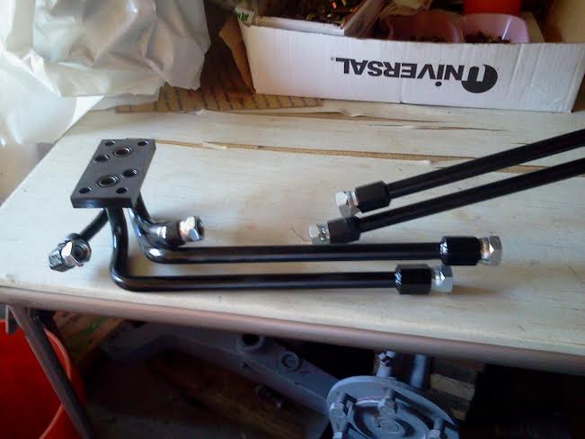

Save Old Iron 1,566 #8 Posted May 17, 2014 excellent idea on the trans tubes 1 Share this post Link to post Share on other sites
brandonozz 168 #9 Posted May 17, 2014 I have to agree with everyone else, love the story and old pictures..... at least all but one. LOL Looking forward to keeping up with your progress on a great project. 1 Share this post Link to post Share on other sites

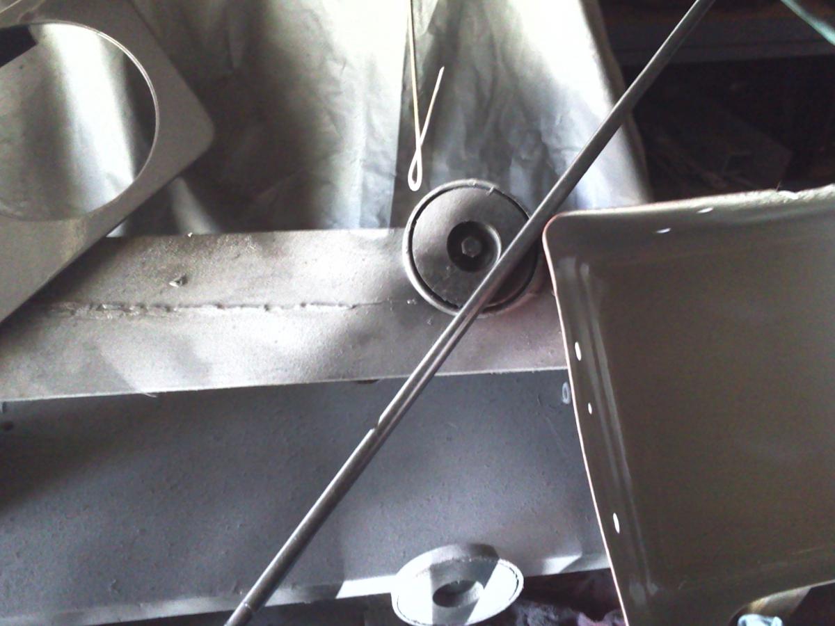

rtfbg 744 #10 Posted May 24, 2014 Not making much progress ... friggen HOT!!! Anyway, I had some old magnets laying around, so I bolted them to an old wood rack, and came up with a great table top tool for holding part. They are strong enough to hold whatever I put up there ... well, not the axles!! You can see one here holding a fender, plus a few other little pieces. 2 Share this post Link to post Share on other sites
AMC RULES 37,118 #11 Posted May 24, 2014 Humm...the magnets are a great idea. Share this post Link to post Share on other sites
Racinbob 11,014 #12 Posted May 25, 2014 I just gotta ask. The magnets. Perhaps the bases to old magnetic mount CB antennas? Strong little buggers. Share this post Link to post Share on other sites
rtfbg 744 #13 Posted May 25, 2014 Close!! I used to have a lightbar mounted with them. They are rated at 500lbs ea. and if you put a flat piece like a fender, you really have to use leverage to get it off!! lol They sell them at Harbor Freight, $10ea I think. 1 Share this post Link to post Share on other sites
