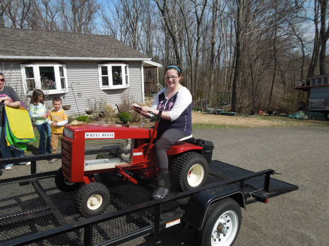

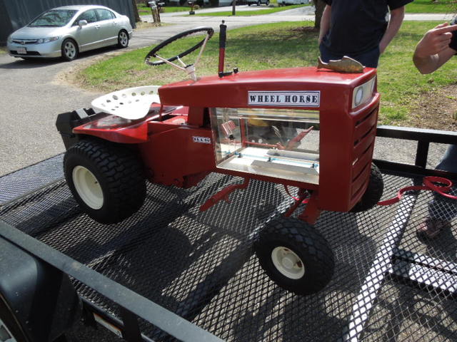

wallfish 17,383 #1 Posted April 25, 2014 A friend asked me about doing a custom tractor for his daughter. She came up with the idea of a fish tank tractor and this may be a custom that hasn't been done to a Wheel Horse before. It started out as a beat up Lawn Ranger but now has a C hood to completely cover the tank. Runs with a starter generator motor to keep down vibration. You can kind of see the horizontal tube inside the tank which a strong LED light shines through. Mirrors on both ends really reflect the light and it's even visible in the daylight. Air bubbles use a 110v pump powered using a small inverter. Clutch pedal will loosen the belt like normal operation and when pushed all the way, it will shut off the motor. Didn't get any pics of the top of the tank but it's rigged so the water will not splash out but also allows access to the inside. I don't know how long it will drive using the large capacity deep cycle battery but I'm sure she'll find out tonight after they get home. They plan to have it at the Zagray show in CT next weekend, complete with the tank decorated and live fish. Here's a couple pics of the Wheel Horse Sea-01 and the new owner. 7 Share this post Link to post Share on other sites

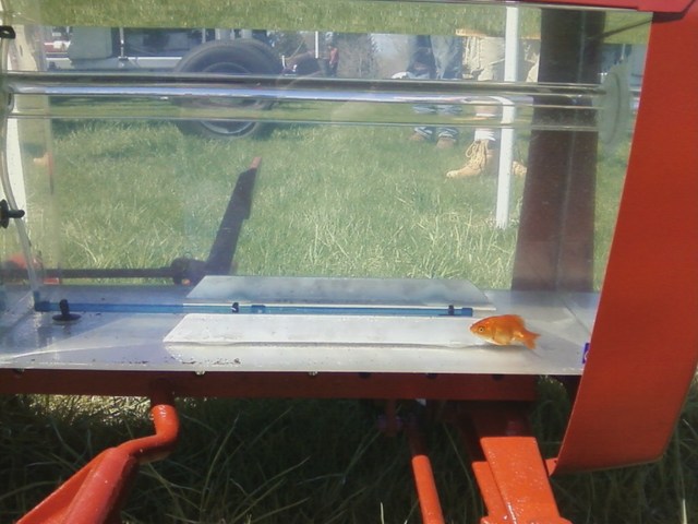

Sparky-(Admin) 21,859 #17 Posted May 4, 2014 With fish......only had my lousy phone camera . Saw it at Zagray's. Mike............ Share this post Link to post Share on other sites
stevebo-(Moderator) 8,395 #18 Posted May 4, 2014 I heard the little fishy almost did not make it... Looked great John. Share this post Link to post Share on other sites
