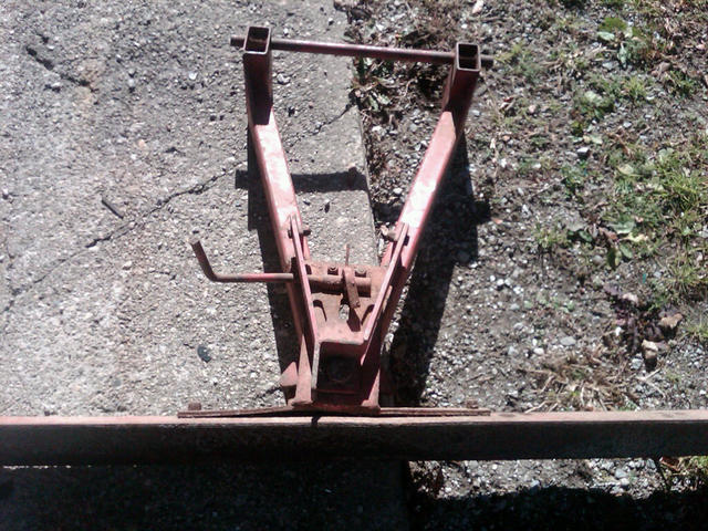

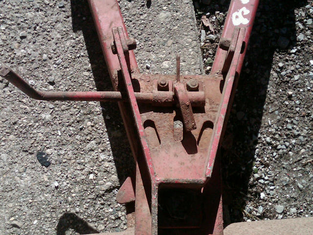

Hello
I bought this blade really cheap at an auction.
It doesn't have a WH tag on it but I;m guessing it is a WH.
Does anyone know what the model number might be?
I would like to find a new lever the controls the angle, it has been cut off and the catch is bent.
thanks
Jeff

Looks like a nice piece of equipment! :WRS:

I think I have the angle lever, give me a day or two to dig around.
ETA: Nevermind, the one I have is for the dozer blade.

Thanks Britt, I guess it would be nice have the spring and the link for the picking it up too

Here are a few pictures of one that I got with a D series, the angle lever is solid round stock and the lift link is just a piece of flat stock if I still had it I would measure it so you could make one but I sold all of my D series stuff last year.
I think the ID tag reads T 1122 but it is hard to read in this picture.
Model number is 7-1122 sold 1975 and the 103347 looks like a 1975 serial number.
There is a 1976 model 67-50BM01 listed in an OM but nowhere else so this may have available through 1982.
Fits 18hp Auto and D-Series except D-250 tractors
Axle mounting bracket interferes with brake drum on 1978 and newer tractors PSB #224A
Manual for the 1973-1974 model 7-1121 is in the files. Do a search using 1121 or 803961
