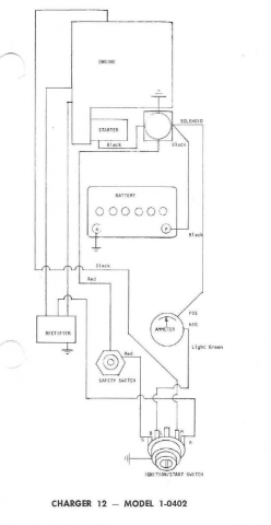

i am looking for a wiring diagram to redo my the jerry riged wiring on my newest purchase. It has a 12hp kohler and starter solenoid

I have a diagram for a 1972 Charger 12. That model has a solenoid. Can't help with a '70 unless the wiring is the same. Does your K301 have an external coil or a magneto?
pumper.atv
external coil
rmaynard
Here is the '72 wiring
post-2221-0-68877100-1350355559_thumb.pn
pumper.atv
Thanks
rmaynard
No problem. Hope that works for you.
pumper.atv
Just curious what would the mag set up look like?
