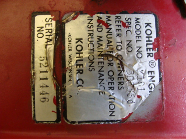

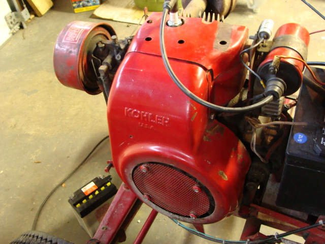

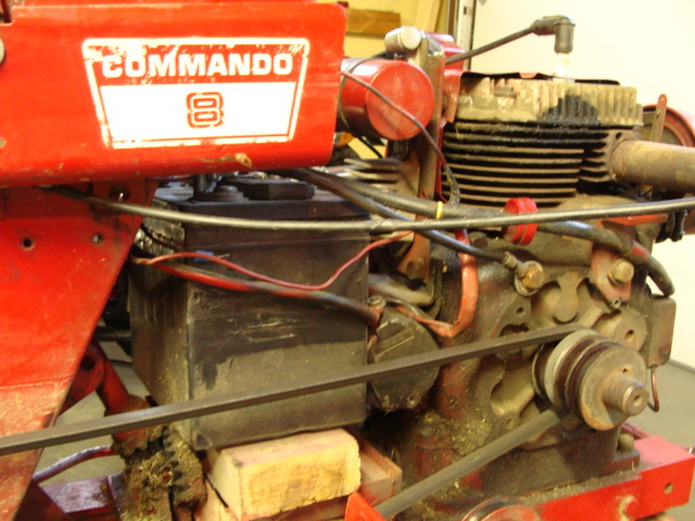

damon91 7 #1 Posted July 16, 2012 Hi there, I am new to this. I just purchaced a 1968 commando 8 which is in fairly good condition and runs good. I am hoping fo fix it up and make it origonal as possible. Here is where my confusion starts. This tractor has a Kohler K181 motor spec# 30536d serial 5211446. from all of the lists I have found, this tractor is supposed to have a spec# 30108d in it. As you can see in the pictures their is paint missing where the starter/generator bracket once was. there is now a modern style starter, and charging system installed (notice the shroud was cut with tin snips to accomodate the starter bendix). From all the lists I have seen, their is not one Wheel Horse listed to have this spec# 30536d, but if you search "spec# 30536d" on the internet it will bring up pages with wheelhorse models 854, and 855's having origonal looking engines with the same spec # as mine. even though the lists say thats not the engine thats supposed to be in there. Have any of you guys run into this or have any insight on the matter? I want to think my tractor has the origonal motor but im not sure Any info would be appreciated, this has me stumped! Share this post Link to post Share on other sites
Sparky-(Admin) 21,551 #2 Posted July 16, 2012 Sounds like the original motor is long gone and a newer K-181 was installed. The starter on the original was mounted up much higher(kinda where your coils is now) and the battery would have sat nicely in the battery box without those wood blocks. Mike......... Share this post Link to post Share on other sites
MarkPalmer 81 #3 Posted July 16, 2012 You can compile the stuff you need on E-Bay to bring it back to original look. You'll need a starter generator/regulator and mounting brackets, flywheel pulley/belt and cover, and the bracket to mount the coil to the front of the engine by the points. There are also two studs in place of head bolts. You would then no longer need the starter or alternator on the engine now. The K181 engine block itself remains virtually identical between the two methods of starting and charging systems. Those parts are usually easy and inexpensive to come across in the Bay. I can tell by the paint markings on the shrouds this engine originally used a starter/generator system. -Mark- Share this post Link to post Share on other sites
Rooster 191 #4 Posted July 17, 2012 Serial number makes that engine a 1973 model....so not original ;) Share this post Link to post Share on other sites
