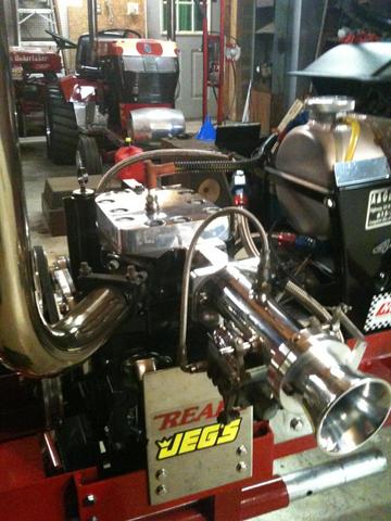

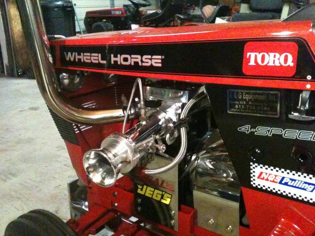

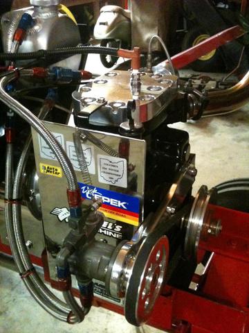

gmalott24 52 #1 Posted April 7, 2012 Trying to get ready for the pulling season and thought I would post a couple pics. 11 1 Share this post Link to post Share on other sites
gmalott24 52 #2 Posted April 7, 2012 And a couple more... 3 1 Share this post Link to post Share on other sites

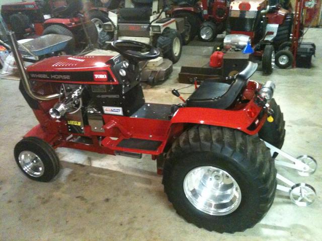

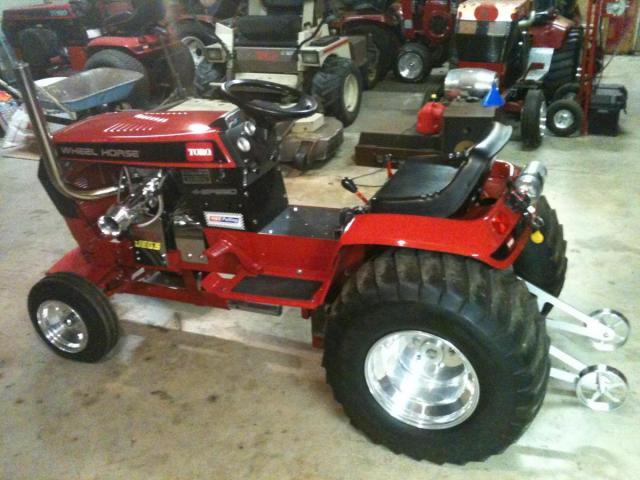

chris11 184 #7 Posted April 7, 2012 very nice, what chassis did you use? Cub cadet 100? Share this post Link to post Share on other sites
gmalott24 52 #8 Posted April 7, 2012 It has a custom built chassis. The only part on the tractor that is cub is the rear end housing. The clutch is a VW and all the gears are aftermarket. Thanks for the nice comments. I enjoy the tractor. 1 Share this post Link to post Share on other sites

gmalott24 52 #12 Posted April 7, 2012 Frustration should be the name of my tractor right now. I think I am battling a fuel pump that needs to be rebuilt. A little more time and I think I'll have him running well. I am also looking to update the rear-end as well. A 24-25-26-27 without a straight axle. The looked rear works well inside, but it makes it a handful on an uneven (varying traction) track! Share this post Link to post Share on other sites

gmalott24 52 #17 Posted April 12, 2012 Jones J1 Block bored to 4.125" with a 3.75" Stroke. Mechanically fuel injected (Hilborn) on Alcohol (Methanol). Custom Aluminum Head. The engine gets about 2 runs on a quart of Methanol. Share this post Link to post Share on other sites
